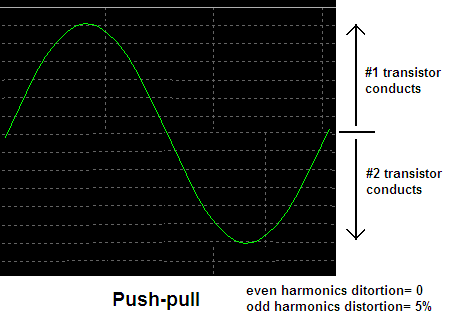

"Push-pull transistors alternate during the waveform. One transistor conducts current when the waveform goes upward, then the other transistor conducts current when the waveform goes downward. "
Using a Single Transistor in normal mode "conducts" current upward and downward whats the difference between Pull-pull VS normal mode?
Because they both "conduct" upward and downard waveforms
A single transistor is non-linear therefore amplifies the top of the waveform a different amount from the bottom of the waveform.
Push-pull transistors amplify their half of the waveform the same amount.
This is a copy-and-pasted sim of push-pull transistors. Each transistor compresses its half of the waveform a little but by the same amount:

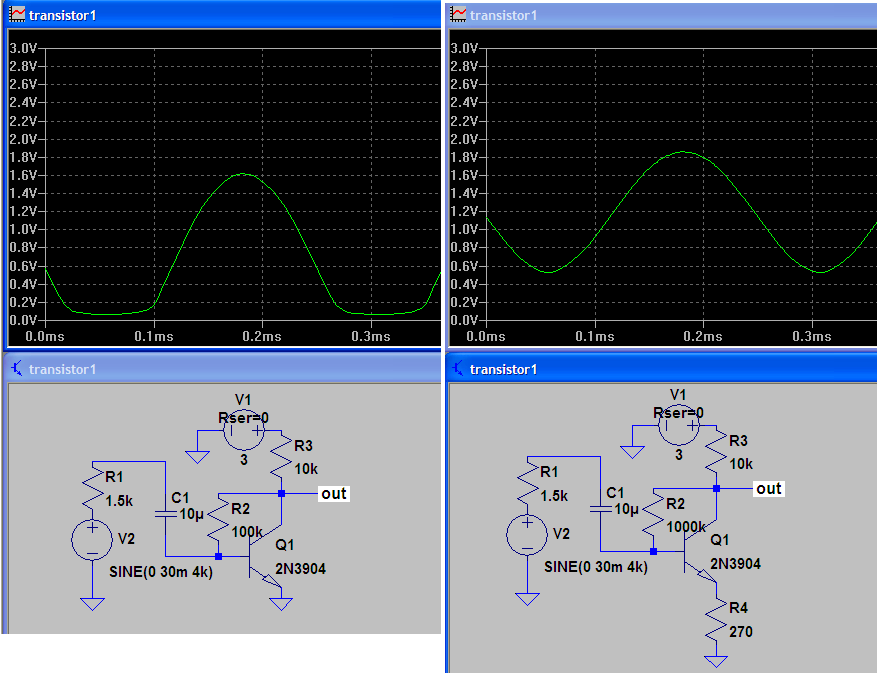

This is a sim of one transistor incorrectly biased so that it clips the waveform's bottom. The other pic shows its output when it is correctly biased and with a little amount of negative feedback to make it even better:

So the "one" transistor has different compression than the push pull mode?
The "one" transistor baised correctly still "conducts" both ways and looks the same as the Push pull mode whats the difference?
From looking at the oscilloscope pictures how can u tell the even and odd harmonic percentages?
If the waveform is clipped on the lower or upper then u say the even harmonics is 40%
In the oscilloscope sim picks where is the 2nd harmonic distortion?

Not really, the single transistor just is DC-offset since it has no means to go negative it must sit on an offset to produce a sinewave, AC-couple will remove the offset tho
Yes. The single transistor compresses the top of the waveform when it is nearly cutoff. Each transistor of a push-pull type compresses the waveform when it conducts the most.
The "one" transistor biased correctly still "conducts" both ways and looks the same as the Push pull mode whats the difference?
I can see compression of the top half of the single transistor's waveform. It isn't much because the emitter resistor adds a little amount of negative feedback to reduce its distortion.
Experience at looking at waveforms on a 'scope and comparing the compression seen with the actual amount of distortion measured on a distortion analyser. I can see 5% even or odd harmonics distortion on the compressed sinewaves on a 'scope. I can hear about 0.1%.
No. If the waveform has asymmetrical clipping then it has even harmonics distortion. The amount of clipping determines the percentage of distortion.
Think about it. You can have an undistorted waveform with only 0.0001% distortion then cause it to clip slightly. The distortion won't suddenly jump to 40%, it might be only 0.1% or less, or more. 40% distortion would be caused by very much clipping and sound horrible (unless you like fuzz).
