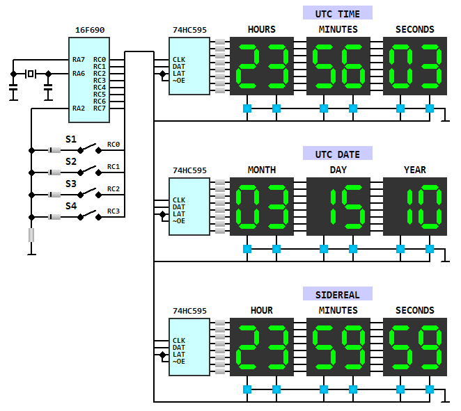

Hi captain',
You asked if you could build a Sidereal Clock with a PIC and I was trying in my own stumbling and bumbling way to tell you that you could, just not exactly in the way you and other Forum members might have imagined.
I asked how you were going to use the Clock because there are plenty of ways to display Sidereal time on your PC or a laptop already. I was curious if you had a Clock circuit and just wanted to drive it with pulses from a PIC "sidereal" time base generator or if you wanted to build an entire Clock with display (LCD or 7-segment) around the PIC?
The code example does exactly what the comments say it does. If you include that very simple driver in a PIC program you can generate 86,400,000 "sidereal" millisecond pulses in an 86,164.1 second day. If you add display hardware and drivers to the PIC and build a relatively simple program you can display local time, UTC time, and "sidereal" time, if you like. Plenty of chaps here on the Forum can help write the program if you're interested in building this project.
With a 'standard' crystal you can expect accuracy of about 1 second per month but not much better then that due to crystal aging and temperature drift. This implies that you should calibrate the Clock before using it to aid in your observations because the time could drift by 20 or 30 milliseconds each day.
Using a TCXO instead of a crystal would improve performance significantly. AADE used to offer a small 1-ppm 10-MHz TCXO board for $15 but I don't see it listed on their site anymore.
So, are you thinking about building somethin' like this or are you just kickin' tires (grin)?
Regards, Mike
