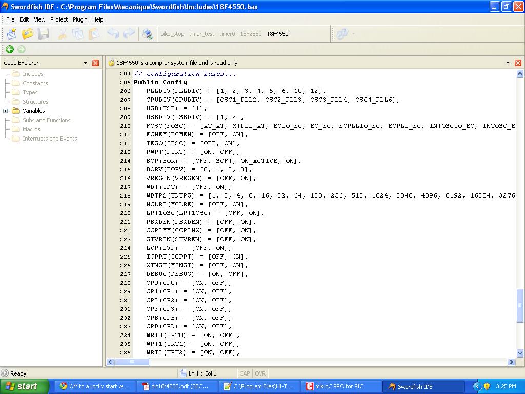

Any idea why this is happening? This is what I dreaded. Being halfway proficient in ASM makes it really demoralizing when you can't even compile a hello world in your new language. LOL
Read my JPUG issues and the Junebug manual on my site for some simple examples. You still have to know the names of the CONFIG registers for the particular PIC you're using. I often use the pic_xxxx.inc file that's part of MPASM (it's a text file and has all the proper names) Swordfish will show you the valid names if you click on the PIC type (it appears after your source code includes the DEVICE = valid PIC statement)
Your problem is still the same no matter what language you use. You still have to use the right register names.
There a easy way to set your chip if you click on the left plane where it shows 18F4550 or what every chip you using a it will pop up the inc file for your chip which list all pin regs and configures for your chip. The 18f4550 needs
 Config FOSC= INTOSCIO_EC

Your code should be like this
Device = 18F4550
Clock = 8
   //// includes here
// alias to port pin...
Dim LED As PORTB.0
// main program...
OSCCON = %01110110    //regs  configures here
Low(LED)
Repeat
   Toggle (LED)
   DelayMS (500)
Until false
end   // the end is at the end

Assembly is invaluable and gives you an excellent understanding of how the CPU thinks. I can program in assembly but I wouldn't tackle a big complex program written in it unless I had to.
When you can write some "if then and for next repeat until " and do what took a page of asm. It makes going back hard LOL
After the recent discussion about Burts INTOSC8.bas module, I thought it would be worth talking about a more extended version which you may find handy with your venture with SF.
The Swordfish User Module Pack includes several useful modules created/maintained by the DD/SFB community, one of them is a variant of the "INTOSC8", namely "InternalOscillator.bas".
The InternalOscillator.bas module will configure the internal oscillator based on the defined clock speed. It simplifies the whole process, and also includes support for very low/fast speeds (such as with PLL enabled). Support speeds are those available between 31Khz to 64Mhz.
For example:
Device = 18F4550
Clock = 8
Include "InternalOscillator.bas"
// now configured to operate at 8Mhz with the internal oscillator!
Device = 18F4550
Clock = 0.031
// now configured to operate at 31Khz with the internal oscillator!
Check out the module notes for more information on other devices supported, and you can always update/request for additional device support!

Does the module check for out of spec frequencies. The max clock for the 4550 is 48MHz (12MIPs)
Hi Bill,
The devices that are supported should validate the clock speeds and produce errors if something is out of spec. Should being the key word!
As always, changes + suggestions are welcomed, it only makes it easier for everyone
It will not set PLL on a 18f4550
#elseif _clock = 16 And _device in (18F2420, 18F2520, 18F2620, 18F4420, 18F4520, 18F4620)
    OSCCON = $6C                                'Set internal oscillator to 4MHz
    OSCTUNE.6 = 1                               'Enables PLL
#elseif _clock = 32 And _device in (18F2420, 18F2520, 18F2620, 18F4420, 18F4520, 18F4620)
    OSCCON = $7C                                'Set internal oscillator to 8MHz
#else
    #error "Can not configure OSCCON for chosen clock speed"
#endif
But it is easy to add to it Andy0 did i nice Job with it.
You guys have given me a great deal of help here. Thanks for that.
Burt: On your IR code, I am curious on something...
I'm sure it's just my ignorance of the language, but how does the actual received value actually make it to the LED Port? It seems to me that the value is never actually passed to "IR_cmd". I see it getting shifted right by one (I think thats what IR_cmd = IR_cmd >>1 is doing) in the for loop after the "start" pulse is confirmed, but if it's initialized to 0 aren't you just shifting 0s? I'm missing something here.
As to the PLL: I'm not intimately familiar with the '4550, but I don't think the PLL is available to the internal oscillator.
