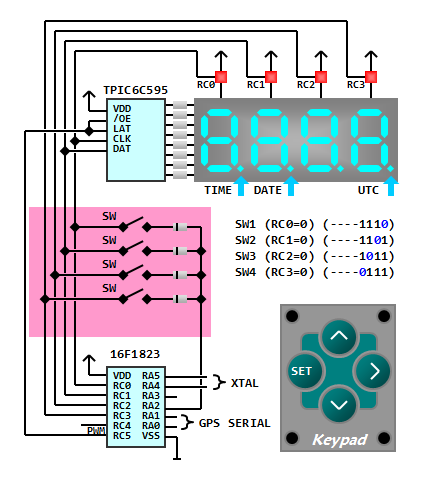

Anyway, I would like to pass along a circuit I use for driving 4-digit 7-segment displays when you use a driver IC (below). Basically it re-tasks a couple of the column driver lines temporarily for use as <clk> and <dat> lines to load the shift-register during a very short blanking interval at the beginning of each display refresh/update interrupt. The drawing shows the PWM signal driving the <lat> and <oe> pins for complete fade-to-black display brightness control but you could use some other pin (without brightness control) if the PWM pin is already in use.
Cheerful regards, Mike
