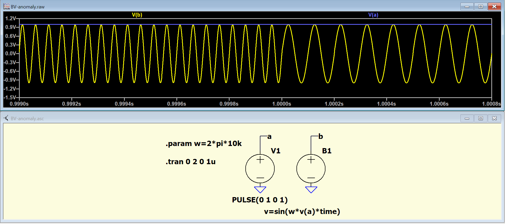

The attached simple sim is meant to produce a 0-10kHz swept sine over a 1 sec period, but instead produces 0-20kHz. Where am I going wrong?

Ok, between us we've got a few workarounds I can live with, but it still doesn't explain that factor of 2.

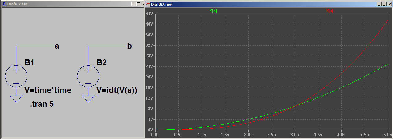

Can you explain? It looks to me that coincidentally, idt(V(a) just happens to be one half of time^2 at time=1s. Why is this any better than just 0.5*time^2 ?
My V(a) plots well behaved. Why do you need to integrate it? If you integrate it, it makes a very different V(b).
It gets weirder. With v(a) ramped from 0 to 1 over 1 sec, followed by v(a) = 1 for 1 sec, a 2 sec sim gives a 0-20kHz sweep followed by a 10kHz sine, with the frequency suddenly halving at the 1 sec point ???
Edit:
Weirder still. Changing V(a) to ramp from 0.5 to 1 over the first 1 sec gives a 5kHz (expected) to 15kHz (unexpected) frequency sweep, followed by 10kHz from 1 sec onwards.
Because the time computation should occur after each time slice (idt()) and then fed to the remainder of the equation.
That's what idt() will do. At least that's the way I understand it.
This also means that "maxtimestep" will have an influence on the results. It should be set to something less than the shortest period. The period of 20khz is about 50us, so I'd set that value to maybe 1us to get good results but not slow down the sim too much.

I extended the sim time from 1 sec to 2 secs so that, from time 1s to 2s, v(a) stays at 1V. That results in LTS correctly identifying the sine frequency from 1s onwards.
I agree the max timestep seems to be the root of the anomaly. I used 1uS for the post #13 sim. If you set maxtimestep progressively >2uS you start to see changes in the sine envelope. Set it at 50uS, for example, and you create a nice noise generator!
It's beginning to look as though any BV expression which is a time function of something which is itself a time function will give unpredictable results.

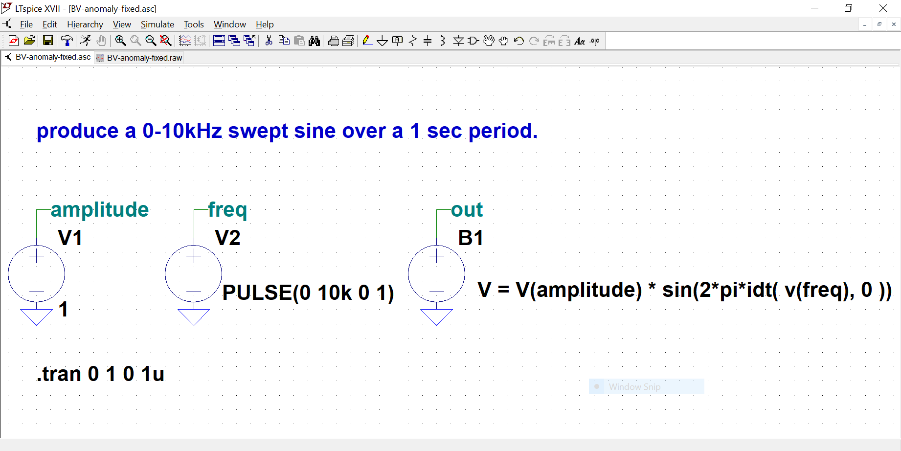

Hi
Yes...the maxtimestep will have an effect. And...yes..you need to use idt() function in the expression or the anomaly (which really isn't an anomaly) will continue.
The attached sim should be self explanatory but V1 adjust the amplitude, V2 adjusts the frequency and rate of change (via rise time).
The output frequency will change based on the rise time set in V2.
eT

Heh...the best way to avoid this type of gocha is to use the LTspice modulate or modulate2 device.
It's designed for this kind of application.
eT
