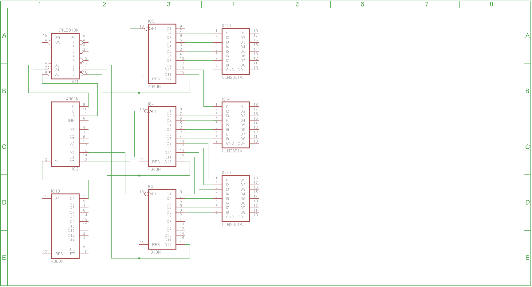

so should I put a resistor in series with the 4051 output and the 4017 clk. so you are saying go to the pin 13 which is the disable pin on the 4017. also would the 74hc4040 be replacing the 4017
A 10K resistor from each clock pin to ground.
But that won't fix the problem of all of the Q0 outputs of the 4017 being high at reset, and until each 4017 gets clocked away from zero. That fix will take adding another 4017 and not using Q0 from any of the 4017s.
The HC4040 would replace the counter part of the 4017s. 10 of the HC238s would replace the decode part of the 4017s. You will also need a couple more 138s or 238s for intermediate decoding.
The 8 outputs of the 238s will drive the 8 inputs of the ULN2803s.
now I am getting confused. so the 4040 will not replace the 4014 it will just replace the counter part. does the 4040 with each clk input move to the next output

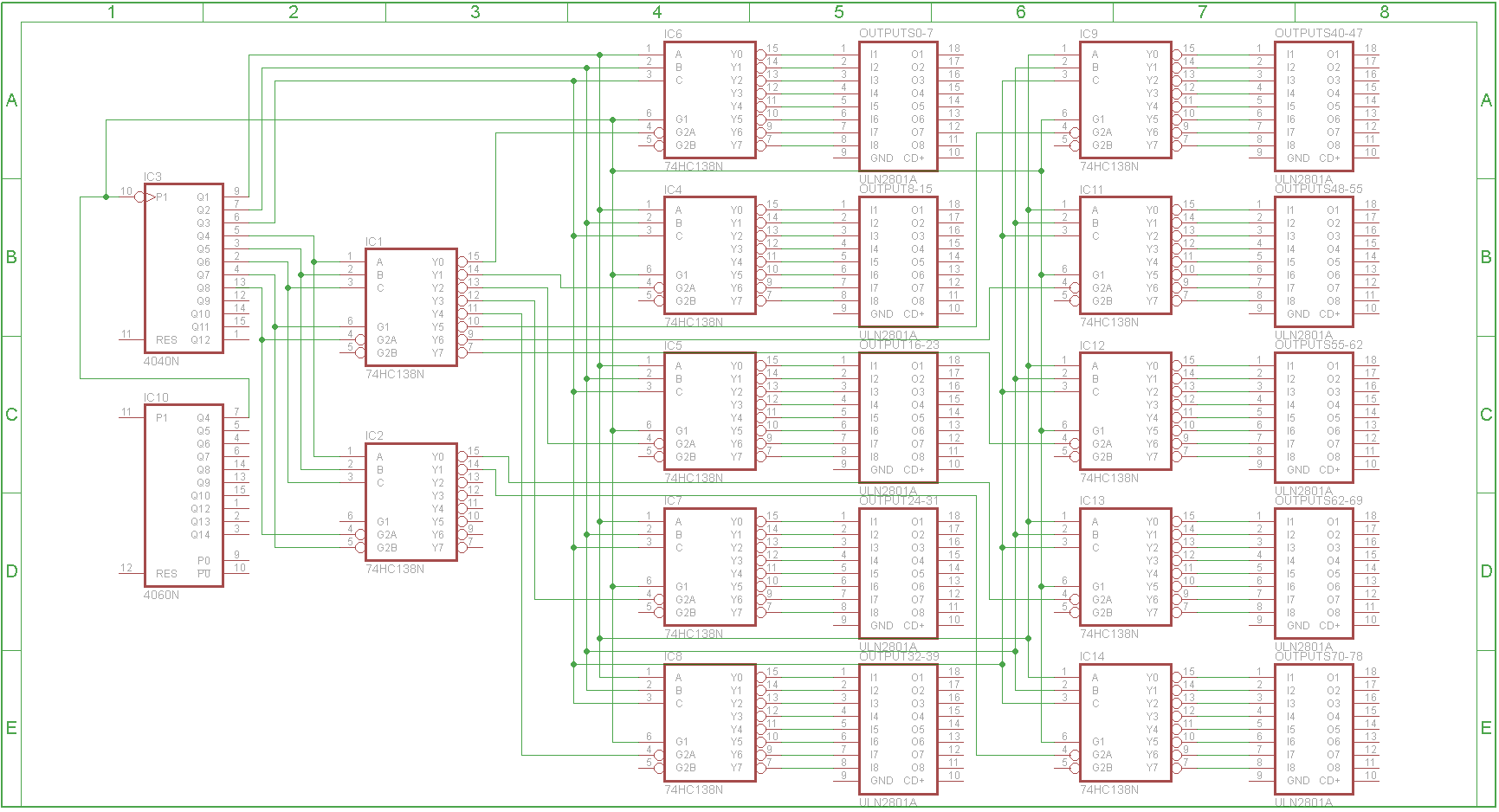

how about this circuit will still have the same amount of outputs as last circuit just cut it down to save time
No, that won't work. You only need a single 4040 in the whole thing.

this is the drawing of that circuit you sent me the only thing is I cant find the 74hc238 on my eagle software
The pinout is the same for both the 138 and 238. The symbol difference is only that the 238 won't have bubbles on the outputs.
Make sure that all input pin are tied either to another output, or +5v or ground. No logic inputs may be left floating!!!!
You will need to add decoupling caps to the layout.
Your schematic shows the ULN2801. If that is what you will be using you need to add a 2.7K resister in series with each ULN2801 input. The ULN2803 already has that resistor.
You can replace the two hc138 parts with a single HC42 decade decoder.
