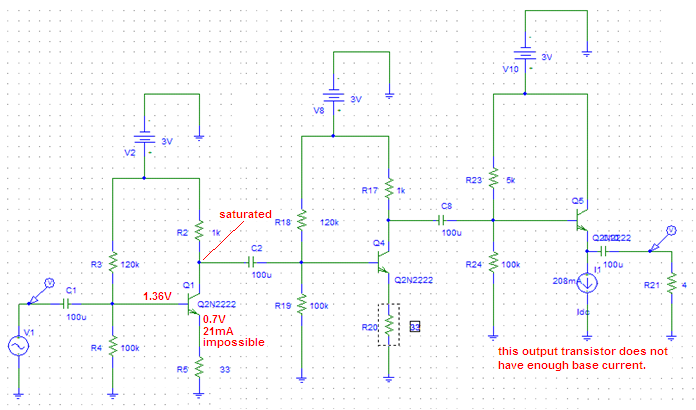

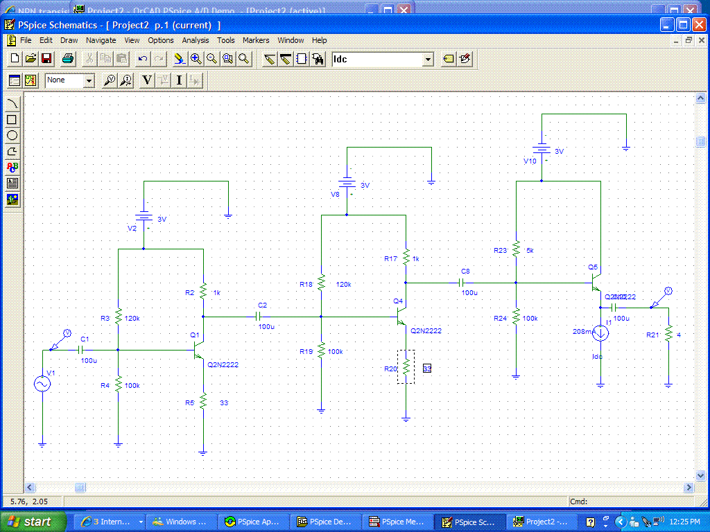

Here is the circuit that I am simulating. When I simulate the last two stages using an input of 1 mVpk I get a gain of about 6 but if I add another stage (as in this circuit) then the circuit saturates at both ends and there is a gain of about 45 on the top swing and a gain of about 80 on the bottom swing. That is really weird.

You should look at DC voltages in your SIM:
1) The first two transistors are saturated so cannot amplify anything.
2) The output transistor does not have enough base current.
3) Why use a class-A circuit instead of a class-AB circuit??

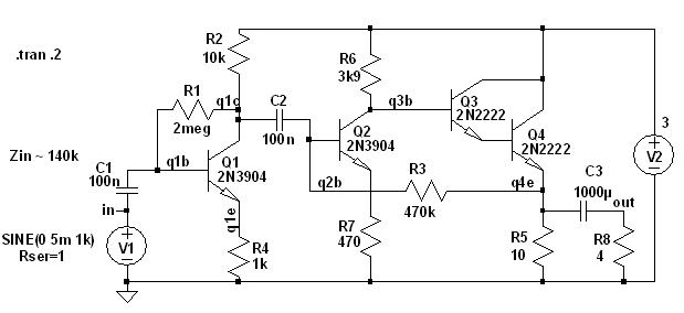

Here's a circuit which (at least when simulated) seems to meet the specs:-
Vsupply = 3V
V Gain = 30 (Vin = 10mV pk-to-pk 1kHz, Vout = 300 mV pk-to-pk))
Zin ~ 140k
Low distortion (2nd harmonic ~ 59 dB down, 3rd harmonic ~ 35dB down)
