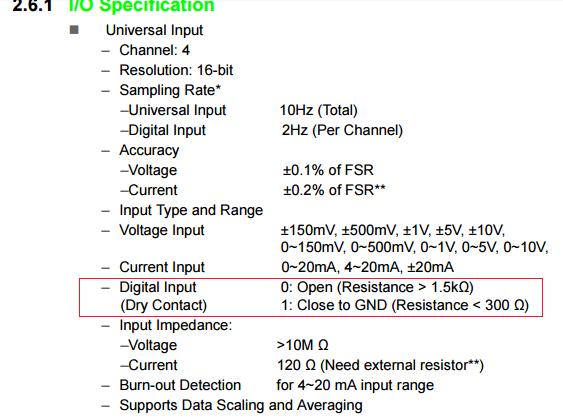

I'm not sure, but I don't think so. The problem is that the transistor can provide the Logic 1- close to ground as per data sheet (same as short ckt), but for the Logic 0, the dry contact wants to see an open, whereas the NPN must have a voltage on the collector and the data sheet of the WISE is not clear on whether or not you can have a voltage on the pin (I'm thinking no). One possible workaround that I can see is that you use your opto-relay to switch either to gnd or +v and feed that to one of the 2 input voltage channels of your WISE. You then use that voltage control input of the WISE to control thru firmware the relay output channel of the WISE. Use that relay channel to control the digital input channel of the WISE, since it is a true dry contact. I know that sounds goofy, but I think it should work... Let me know if that did not make sense and I will make a drawing for you:)

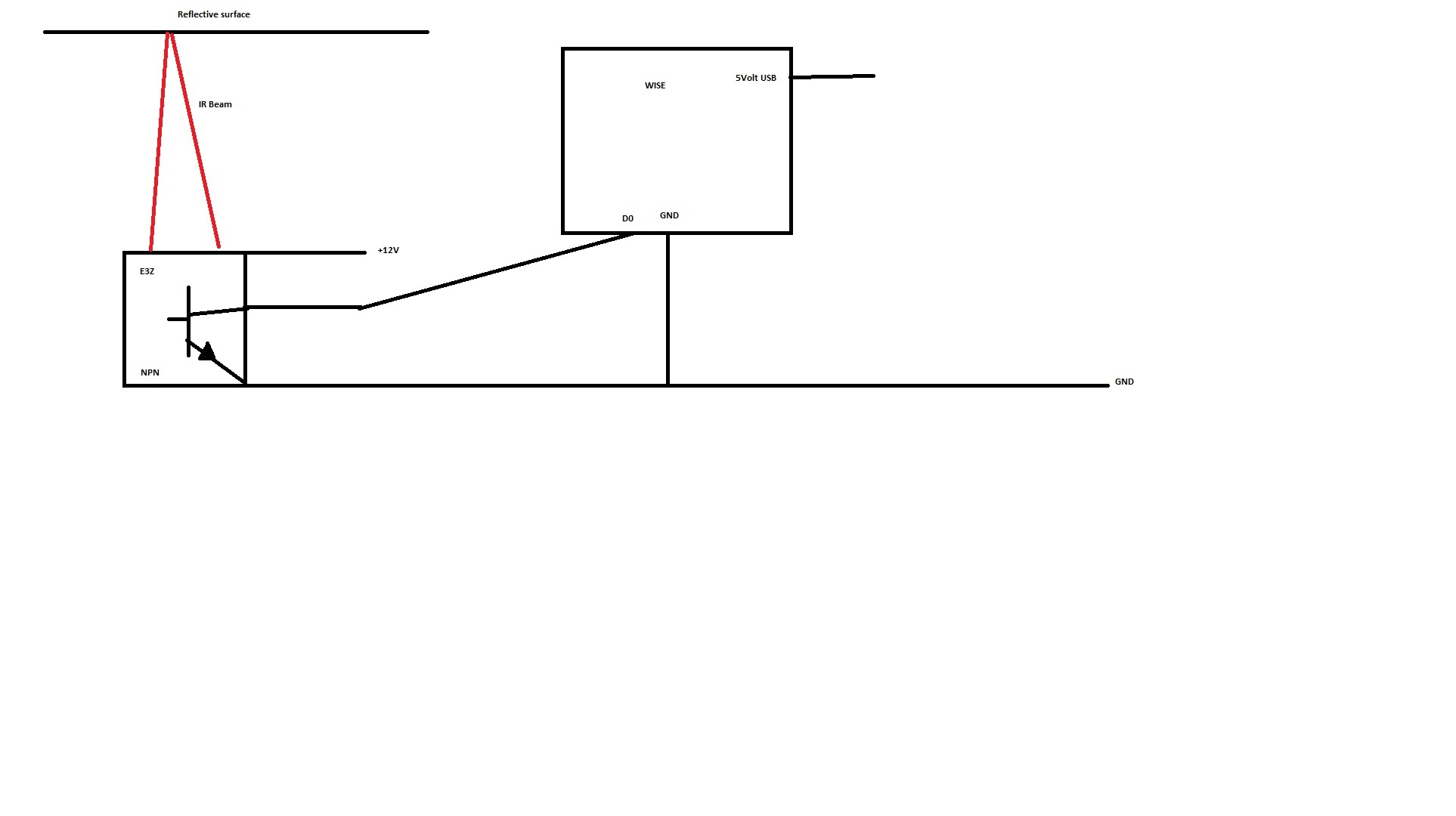

Here is an image of what i thought was going to happen :

BTW, your connection of the Opto device is not correct.

What's wrong with his drawing?
I would expect it to work the way he drew it.
The WISE unit says it's looking for a switch closure to ground. That can only mean it's a sourcing input, looking for a sinking sensor.
NPN sensor, saturated low side switch, that fits the bill for a sinking sensor. When ON, (as he drew it) I would expect the sensor's NPN transistor to pull the input low. When OFF, the sensor's NPN transistor would not pull the input low, therefore it would be "floating" or "pulled up" to whatever voltage the input sources (AKA "open").
Or have I missed something?
The data sheet does not say what is on the input, is it through a pullup? I can't tell, so I am assuming possibly no. If it has a internal pullup in the wise module then he would be okay. Look at the data sheet and see what you make of it. I think I did read that the input impedance was 100K, so I'm thinking no pullup.
I'm thinking the input is an opto. when you short the input, you cause current to flow thru the opto, and therefore input is ON. So maybe not a "pullup" as you would normally think, but when no current flows, the input is effectively "pulled up" by default.

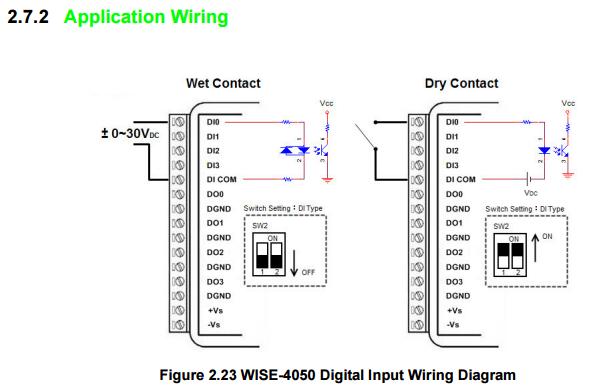

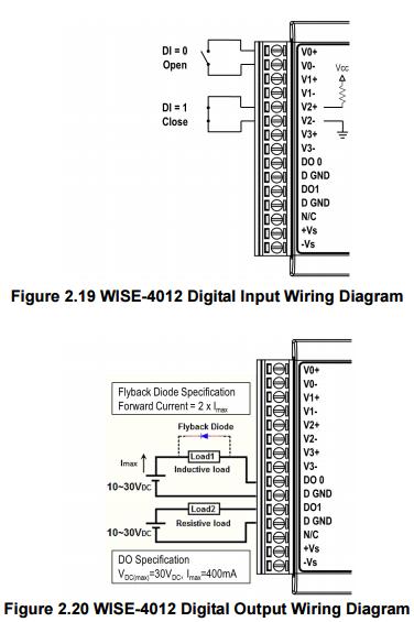

I was able to find more info in the **broken link removed**:
Wiring diagram of how to connect the 4012 (the version RoboWanabe has):
Wiring diagram of how to connect the 4050 (more bells & whistles than RoboWanabe has):
Since the 4050 has the option for choosing sourcing or sinking inputs (they call it wet contact or dry contact), they go to the trouble of providing a meaningful hint about the internal configuration. Since the 4012 doesn't have that option, they provide only a half-ass clue. But even the half ass clue shows a pull up.
One thing this means, if the 4012 does indeed have the same sourcing ("dry contact") input circuitry as the 4050, then DI COM is actually a POSITIVE common, and should not be connected to GND.

Also if it helps the discussion, i have measured 5 volts on D1 and Gnd. So i presume it is using a pull up resistor?
