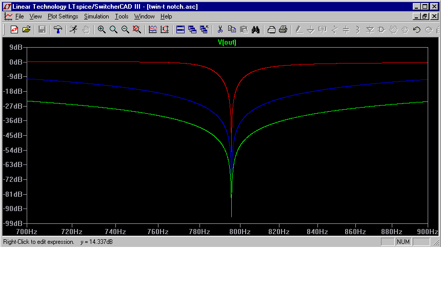

The twin-t notch by itself has very low Q, which means the notch is very broad. You can improve it dramatically with bootstrapping (feedback). See this app note. I wouldn't use such large resistor values (and small caps). I would use R=20k and C=10nF. Make the pot 10k. You don't have to use the op amps shown. I would use something like LM324 (a quad op amp), and add another voltage follower (output tied back to inverting input, as in the other two in the schematic) in front of the twin-t. You still have one more op amp, which you need to tie as a voltage follower and ground the non-inverting input to prevent it from possibly upsetting the internal biasing of the other three. You will have to tell us what power supply(s) you have available, and what the DC level of your input is. Below are simulations of the circuit with the parts I recommended. The three traces are for the pot at the bottom of its range (yellow, no feedback), at 80% rotation, and at 99% rotation. The circuit doesn't work well at 100% rotation because of the op amps' low bandwidth, so you might want to add 100 ohms in series with the top end of the potentiometer. You might also want to add a resistor in series with the grounded leg of the pot to limit the range.
Important: Don't try to put this between your amp and your speakers. It won't drive speakers. Put it in front of your amp.
The lower waveform is a frequency zoom of the upper one.

Thanks so much for the quick responses.
Is there any way I can do this without using the opamps? I was trying to accomplish this with just an RC circuit.
I am using a 12V, 1.3aH lead-acid battery as the power source which I pull out and charge when needed.
AFAIK, the twin-t is the only passive RC notch circuit. LC circuits can have higher Q, but they require large inductors for low frequencies.

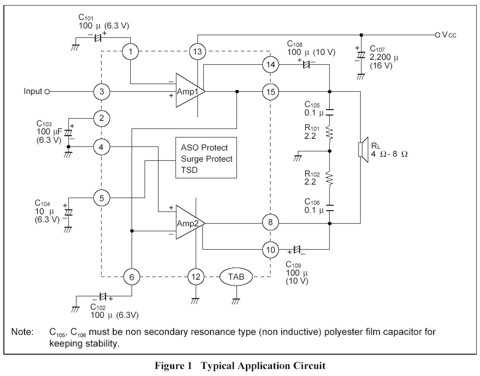

I think you are correct in suspecting that the speaker is resonating at 800Hz. The circuit is the "typical application" located on the chips datasheet (see attached). I just need to fine tune the speaker to the enclosure, and remove the unwanted frequency.
Well that looks pretty straight forward, what about the preamp?.
BTW, do you have anpther speaker you could try, or even a pair of headphones (remembering to feed them through an attenuator).
I'm not using a pre-amp due to the fact that my guitar (Ovation) has a built-in preamp circuit. I'm not sure what this looks like as I have not taken it apart.
I've tried several other speakers which vary in freq. response, however the overdriven 800Hz sound is prevelant in all.
If that schematic is an accurate representation of your amplifier, I think I see your problem. Why is there a 100uF capacitor connected from the output of amplifier 1 to ground at pin 6?
I would suspect that the diagram (which is simply a manufacturers suggested use) doesn't show all the components in the chip. I would imagine that the capacitor on pin 6 is actually decoupling the bottom of the negative feedback resistors to chassis.
