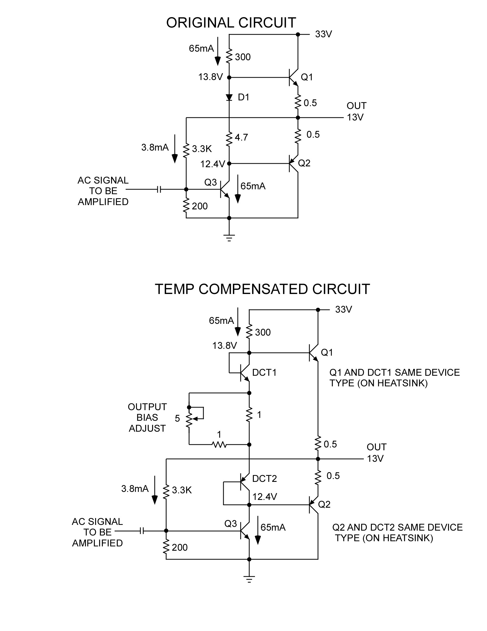

The diode type is not that critical, only that it is normal silicon, not germanium or hot carrier.
Temp comp'g two output transistor Vbe's with one diode is not very effective. If there was two diodes in series then, yes, they are more critical.
There looks to be 60-75 mA of driver current so the output devices are in cutoff at idle. Probably has pretty poor crossover distortion.
Well, I suppose I should explain the OP's circuit operation in detail to show why I was saying what I did just in case somebody here wants to learn something. I drew an attached simplified schematic (see below) to explain how the original circuit works and why it is such a piece of junk.
(All the voltage readings shown on the schematic are from the original schematic.)
The two output transistors Q1 and Q2: they have D1 and a 4.7 Ohm resistor connected across their bases. 19.2V is across the 300 ohms which puts 65mA in the D1 side bias chain. The output current is "set" by D1 and the 4.7 ohm resistor which forces a voltage across the base-emitter junctions of Q1 and Q2 which forces a current through them. This perverted "pseudo current mirror" is what is supposed to control the output stage idling bias current. It can only do it poorly at best because a resistor does not track a diode junction: as the output transistors heat and cool, the output stage bias current will change. Note that the DC output voltage is at 13V which is only about 1/3 of the positive rail voltage of 33V. That's odd, usually you set the output's DC point center range to allow symmetric signal swing going positive and negative from the middle. But this design has another bad feature: that 300 ohm resistor is not a current source, and as the output voltage moves more positive toward the 33V rail, the current through the 300 ohm resistor diminishes, and that current is the base drive for Q1. In other words: the top output transistor Q1 gets "starved" off as the output stage signal swings positive. Setting the output bias point at 1/3 rail voltage may be because of this effect, cenetering the operating point in the useful range of output voltage excursion.
What sets the DC output voltage under no signal? Basically the 3.3k resistor in series with the 200 ohm resistor at the base of Q3. The no signal output voltage will roughly be the VBE of Q3 "gained up" by the ratio of 3300/200. As Q3 pulls current in it's collector, it moves D1 and the 4.7 ohm resistor up and down. Q1 and Q2 move along with D1 and the 4.7 resistor because they are tied at the bases.
The output DC bias voltage point is also the equilibrium where Q3's base current can just drive the Q3 collector current coming down the bias chain which is about 65 mA (Note: since Q3 has a 200 ohm base resistor to ground which eats up about 3.2 mA of the 3.8 mA coming back through the 3.3k resistor, the base drive for Q3 is what's left which is about 0.6 mA).
There is negative feedback on the output voltage DC set point since as the output moves down, the current through the 3.3k resistor goes down (and vice versa). The worst aspect of this design which makes it blow up is that the output stage current is very poorly related to the bias chain current and will not track over temperature.
TEMPERATURE COMPENSATED FIX FOR THE BIAS PROBLEM
The schematic below the first one shows how to fix it using diode connected transistors which are the same devices as the output transistors, so their characteristics will be very close. In this case the bias chain and the output stage form a true current mirror, and the adjustable resistor in the bias side allows the user to adjust the output current. Since the transistors are the same type/maker and operating at the same temperature, the output bias current should track very well over temperature. Once set, it should not wander around.
Basically, you still force the same current in the bias chain but in this design, the output stage will mirror it but at a lower magnitude as ratioed by the emitter resistors of both sides. If the total resistance in the output transistor emitters is equal to the resistance in the emitters of the DCT's, the currents will be the same. If there is more resistance in the output emitters, they will have less current. The variable resistor is included to allow adjusting the output current. If my calculations are correct, the output current should be adjustable from about 15mA to maybe 80mA.

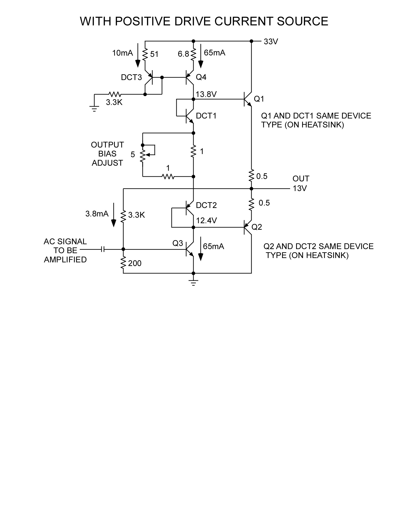

ADDING A TRUE CURRENT SOURCE TO DRIVE THE POSITIVE OUTPUT TRANSISTOR:
It's easy to replace the 300 ohm resistor with a 65 mA true current source which will provide a constant 65 mA of drive capability to Q1 regardless of output voltage swing (see below).
DCT3 and Q4 are same type of transistors, DCT3 acts as a diode with a 3.3K resistor to ground which creates 10mA of current through it. That current mirrors over to Q4 but is gained up to 65 mA because the emitter resistors are not equal and that forces a different current through Q4. The higher power dissipation in Q4 (about 1.9W) would require a small heatsink on it.

But this design has another bad feature: that 300 ohm resistor is not a current source, and as the output voltage moves more positive toward the 33V rail, the current through the 300 ohm resistor diminishes, and that current is the base drive for Q1. In other words: the top output transistor Q1 gets as the output stage signal swings positive. Setting the output bias point at 1/3 rail voltage may be because of this effect, cenetering the operating point in the useful range of output voltage excursion.
Do you forgot about bootstrap capacitor C111?
So, Q1 will not "starved" off.
And current that is flow through R127 will not diminish, the voltage across R127 is kept constant by bootstrapping "effect".
Nevertheless very good post.
I see the cap. It will provide some current, but that cap is driving two parallel resistors of 150 ohms each when it swings positive: it feeds R127 and also the other 150 (R126) resistor bact into the 33V rail and whatever capacitors are on that line. That makes the time constant of the cap and resistors about 3.7 milli seconds. It certainly will not hold the voltage across R127 constant, it will support Q1 with some transient drive as long as the frequency is high enough.
In this country, amplifiers are specified from 20Hz to 20kHz operation. That capacitor might help at higher frequencies, at lower frequencies it will not do much. It is a cheap substitution for a better design.
My point was, it's very easy (and doesn't cost much) just to use a current source that will provide constant base drive current to the top transistor regardless of output swing. The output stage has strong drive at the bottom from Q105 for swinging negative. If the top transistor had strong and constant drive to go positive, the value of R124 could be increased to move the output's DC set point to halfway which would be about 16-17V, not 13V as shown. That would give more signal swing room and allow more output power.

and makes the necessary adjustment in the bias current. The drawback
of course is that it requires the use of some op amps and so this
introduces some complexity in the circuit. What it doesnt fix is the
zero offset problem which still needs to be adjusted for a perfect zero
out for zero in, and also there is still some crossover distortion using
bipolars, but of course the crossover problem can be almost eliminated
by using MOSFETs instead. Since the design gets more complex however
it may be better to simply redesign the entire output stage using op amps
and MOSFETs and get a really clean output that is always biased perfectly.
I suppose given enough money and size, anything is possible. I was keeping it real as something a person could buy and install into the existing assembly.
Let's try some reality: what does it cost to chuck the huge "bootstrap" capacitor in favor of a dual transistor current source?
Let's try some more reality, in the days that bootstrap capacitors were originally used a capacitor was a tiny fraction of the cost of using an extra VERY expensive transistor. Transistors were VERY, VERY expensive devices back then.
The high quality of the sound such amplifiers give (and many of the best sounding amplifiers ever made used bootstrap capacitors) means that they are still used today in some designs, including very highly rated ones.
I've designed amps using both types over the years, and never noticed any differences - if I was designing an amp tomorrow, I don't know which I'd use?, as I see it there's no real difference in performance.
As for your hatred of Vbe multipliers, why this fixation on 'perfect tracking'?, the bias components have TWO functions, to prevent crossover distortion, and to prevent thermal runaway - which Vbe multipliers do perfectly. Which is why they are still usually used in the highest quality amplifers.
So, when are we fixing (or advising the OP on a course of action to fix it)?
Oh, yeah... today. So I should advise an inferior circuit because it was a better choice 60 years ago? OK, I'll stick with mine.
The high quality of the sound such amplifiers give (and many of the best sounding amplifiers ever made used bootstrap capacitors) means that they are still used today in some designs, including very highly rated ones..
Look, using a current driver with a terrible frequency dependency doesn't contribute to hi fidelity. It doesn't do anything good or better than using a current source, it's just cheaper but not cheaper enough to interest me in using it.
If high end designs are actually using it, I think that's pathetic. It's just an inferior design technique and that really isn't debatable. Other than saving a few cents, it has no advantage. I suspect if there are high end designs using it, that's because they used a "legacy circuit" or a design from an old guy who did it because he always did it that way. But it's not superior, it's inferior.
You seriously can't see how that output stage would have a drive problem at rated voltage swing at frequencies below 100 Hz? You can't be serious. At 20 Hz, the wave period is 50 milliseconds (12.5 ms to go from zero cross to the peak amplitude) and your bootstrap cap's time constant into it's resistors is less than four ms. There isn't going to be any usable voltage across the cap by the time the output tries to swing to the top of the peak of the sine wave. You can't see that driver is going to go away at the low end?
As for your hatred of Vbe multipliers, .
:D:D:D Non sequitur. Just because they are not the best design, doesn't mean I hate them.
There is no perfection, there is the one that tracks best. Let's see, these amps tend to blow up as evidenced by:
a) the crappy design
b) the fact the OP is trying to fix one that blew up
Why would you NOT go for best tracking to prevent thermal runaway which is clearly what is killing them?
NO, NO, NO NO.... and NO. VBE multipliers do prevent runaway better than a resistor/diode, they do NOT do it perfectly and they do not do it as well as a design with DCTs. Draw the circuit for a VBE multiplier, or model it, and notice a couple of things:
1) The VBE multiplier uses an NPN which should match an NPN, not so well the PNP. At least not as well as a PNP would.
2) The multiplier is forcing a voltage across two VBE's, one PNP and one NPN.
The base current flowing into the VBE multiplier's transistor is an error term in it's action as a diode.
A VBE multiplier might work. To do it, you add a transistor and resistors. Add one more transistor and you get a better design which will track better. Nothing personal, it's just a better design.
As for eliminating notch distortion, the key is to set the output bias at the optimal current and keep it there. Which one keeps it there better? The one that tracks better and drifts less.
