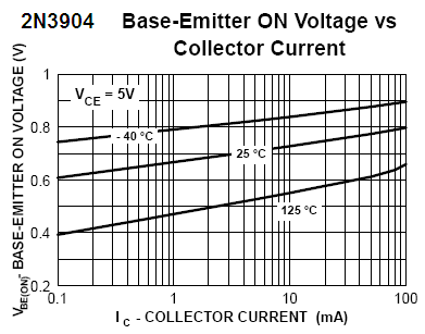

The base-emitter voltage change with temperature shows almost the same angle when the current is changed. So temperature has little effect on a transistor's Re.
True. Re changes about 0.3%/°C, deduced from the fact that room temperature is about 300°K. (1/300~0.3%).
