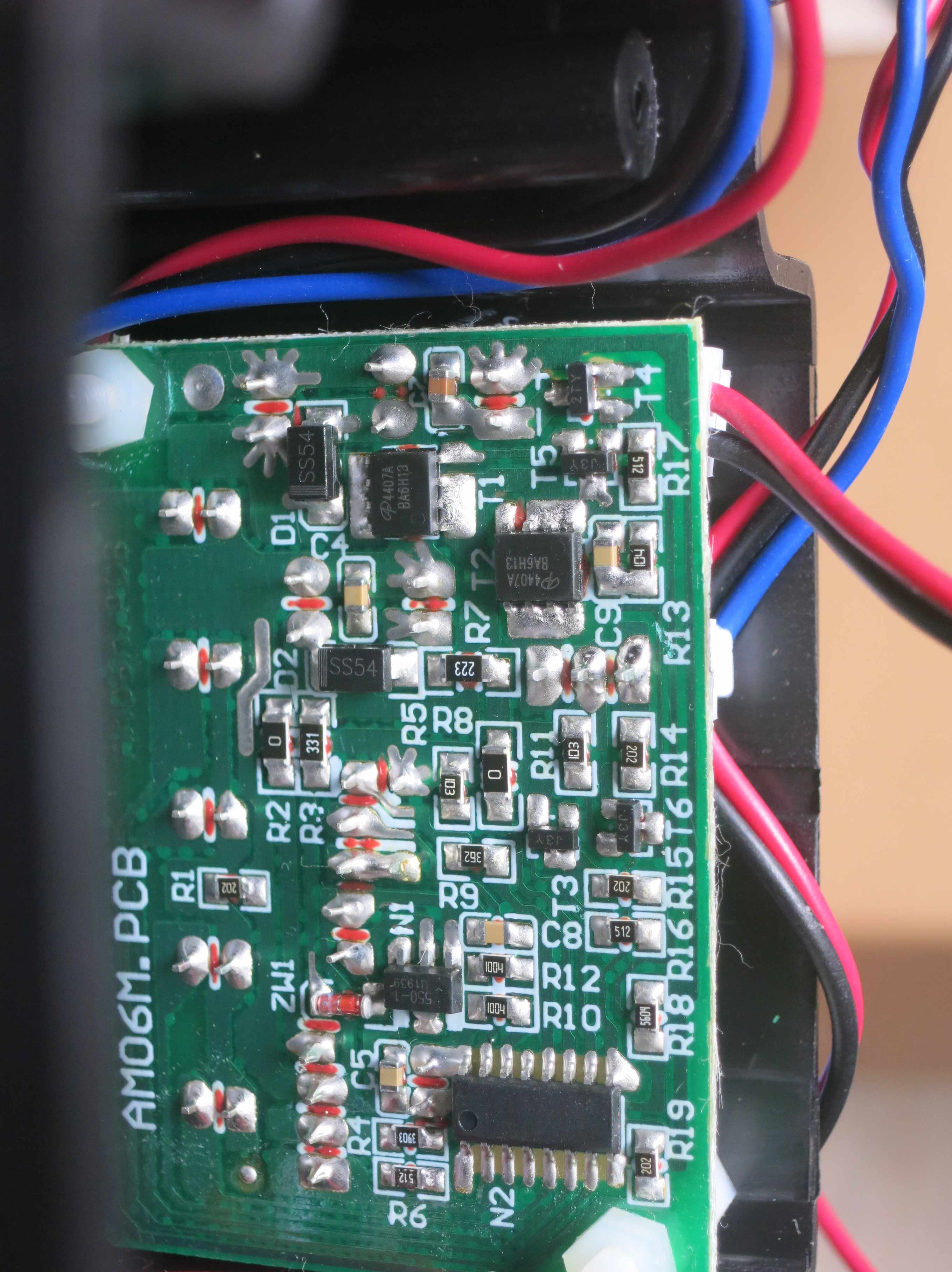

Not able to recognise this motor type
Replace D1 with the same part number. (Or use a device with the same or higher current rating.)

I removed D1 and tested. But only LEDs are working not Fan. Do I need to add New D1 ?
Assuming it's just a protection diode?, then it does absolutely nothing until you connect the battery the wrong way. Stick a diode in and try it - you could hang a through-hole one across the board for testing (1N4001 etc.)
I agree with Nigel that it should work without the diode.
Can you elaborate when you say that the LEDs are working. I would expect them to light up in different patterns to indicate some state of operation. For example on/off timing functions, fan speed etc. We don't have a manual for your fan so we can only guess what the LEDs indicate. Does turning the potentiometer do anything ? Is there any voltage (And what is it) between the GND and VDD pins of the fan connector ? You are making it difficult for us to help you by not answering questions and providing VERY limited information.

I think the "Capacitor, no details" is actually an inductor, so the circuit T1, L?, D1 C? is a buck converter for battery charging.
Looking at the graph in previous post we can see the current is controlled.
Replace the same SS34 schottky diode, check replace the MOSFET & capacitors.
It looks like the + solder join of battery connector is cracked.
Toni
I agree with Toni that the item that marked as "capacitor no details" is an inductor. (It looks like an inductor AND is marked L1 on the PCB.) I did not bother mentioning this as I assumed it was just for power supply filtering but I think Toni is correct that it is part of a switching regulator. (And I was wrong about D1 being for reverse polarity protection.) When you eventually get round to answering the question about the semiconductor part numbers (Particularly T1 and T2 so that we know if these are P channel or N channel devices.) we will get a better idea of how the circuit works.

They would be P-ch HI side switches as the gate is switched between +V & -V by gate drive T4 & T5 <-- PWM from uC.
There is a blocking diode D2 that prevents +Vbat backfeed to DC in connector.
I found a photo from last year of mine, can see the MOSFET numbers (BA6H13) but I cant find any data.
Schottky diode D1 would likely have cracked due to excess reverse current if its breakdown was compromised, possibly due to intermittent battery connection? or maybe just a bad part.
Testing... (bare board, connectors removed)
If you set your meter to Diode test, check D2 for about 0.5V one way & much higher the other.
Do the same with the 2 MOSFET's T1 & T2 Drain & Source (pins soldered together in my picture). They should test similar to the diode. If it shows about 0.1V then likely dead diode/MOSFET.
If T1 or T2 dead then will need to check driver transistor pairs T4 T5 & T3 T6. These are likely small signal BJT.
If D1 is removed & is the only component fault, fix solder join to battery & battery has charge the fan should run, this is a good test.
Looking at the PCB copper, Battery V+ comes via L1 -> T1 -> T2 to Fan VDD pin.

Hi Tony, I have found a datasheet for the 4407A mosfet.
http://aosmd.com/pdfs/datasheet/AO4407A.pdf
With the limited part of the schematic I have traced out I cant understand why the drain of the P channel mosfet is connected to positive.
The Drain of T1 is to battery positive, is this what u mean?
Source (3 pins) of T1 & T2 are connected to +DC in via Diode D2.
This is how I see it working...
T1 is PWM'd via buck circuit to the battery & T2 would be just switch on while PWM goes to the integrated BLDC controller inside the motor.
To run off battery T1 & T2 are switched on (T1 body diode conducts initially.)
If the DC in is on & the fan is switched on, i assume the MCU via R7 22k senses Vin & stops T1 PWM (buck), maybe motor load is enough to control charge current if T1 on.
If I get time I will check the motor PWM characteristics.
