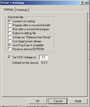

Also how come no one told me about this feature:
vdd-jpg.35360
i just fried 2 MicroSD cards heh a 2GB and 1GB
Using that can i safely set the max VDD to 3.3v? I had a couple issues where my power supply was unplugged and PICKIT supplied 5v heh and found out TRACK 0 is dead.
It does set the voltage.
As I recall the problem is that it does not stay set. I think you have to reset it after you connect each time. Not sure at all. Could have MPLAB and PICkit2 software confused...
Rather then mess with it I provide a 3.3V supply to the target.
3v0
I supply 3.3v also but as noted before sometimes my power gets discnnected and pickit powers it heh. So I'm looking forward to this actualy working

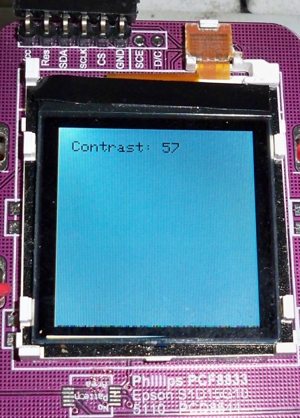

works like a charm!
cont-jpg.35476
void main(void){
    ADCON1 = 0x0F;
    LCDInit();
    contrast = 57;
	LCDCommand(SETCON);
	LCDData(contrast);
    LCDFill(WHITE);
    sprintf(tempStr, "Company: %s",company);
    LCDPutStr(tempStr,10,10,0,BLACK,WHITE);
    sprintf(tempStr, "Contrast: %d",contrast);
    LCDPutStr(tempStr,20,10,0,BLACK,WHITE);
