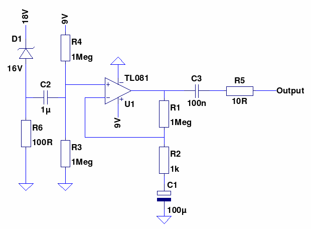

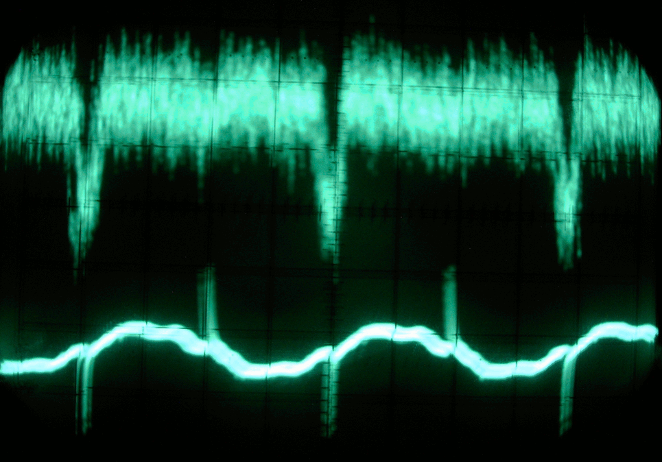

I'm building this noise generator to drown out my tinnitus but according to the scope waveform it appears to be picking up hum.
I know the TL082 doesn't have enough open loop gain at the middle of the audio bandwidth for a gain of 1001 but this is just a proof of concept circuit at the moment.
I assume, it's picking up hum because I built it on a breadboard and the long leads are picking up the mains. The interesting thing is it's only picking up the negative cycle at half the mains frequency. The power supply is my bipolar power supply which seems to be alright hum-wise.
Attached is the schematic and the waveform. The top waveform is the output from the noise generator and the bottom is the waveform generated when I hold the oscilloscope's probe and pick up hum.
I will build this on a propper PCB but before then, I want to ensure it works properly. Is there anything I might be doing wrong?

Your zener diode is connected upside down. So instead of zenering and making a lot of noise, it is just an ordinary forward biased diode but with a lot of current. So that explains why the gain of the opamp must be so high.
Also,get rid of the breadboard and make the circuit properly.
You're right, the zener is upside down but it's only a schematical error, the zener in the real circuit, is the right way up. I've edited the attachment.
I suppose I'll have to build it properly before I can get it to work well.

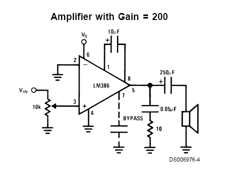

I'm going to connect a small speaker so I've decided to move most of the gain to the LM386 because the op-amps dont't have enough bandwidth over the audio range.

I have a question regarding the LM386 circuit: what value coupleing capacitor should I use?
The datasheet says 250:mu:F but with an 8:eek:hm: speaker the lower cut-off frequency will be:
[latex]F_{C}= \frac{1}{2 \pi RC}= \frac{1}{2\pi 8 \times 250 \times 10^{-6}} = 80Hz[/latex]
I've worked out that for 20Hz I need a 1000:mu:F capacitor but is it really worth it as my cheap speaker will probably also roll-off at 80Hz.
Should I bother with 1000:mu:F or go for 470:mu:F which will give a roll-off of just over 40Hz and might be a good enough compromise?
Another question is, I'm tempted to go for a larger capacitor than 50:mu:F for the ripple by pass capacitor; is it worth it? I'm going to use unregulated supply and ams worried that a 47:mu:F capacitor at worst case might be only 37.6:mu:F (-20% tolerance) so it might not be good enough. I'm tempted to go for 68:mu:F or even 100:mu:F.
To be honest, I've never used an LM386 before and I want reasonable performance but I don't want to use too oversized components.

Use a high value output capacitor so the LM386 amplifier can damp the 100Hz to 200Hz boom sounds of the cheap speaker resonating.
You want wideband smooth noise, not a bongo drum.

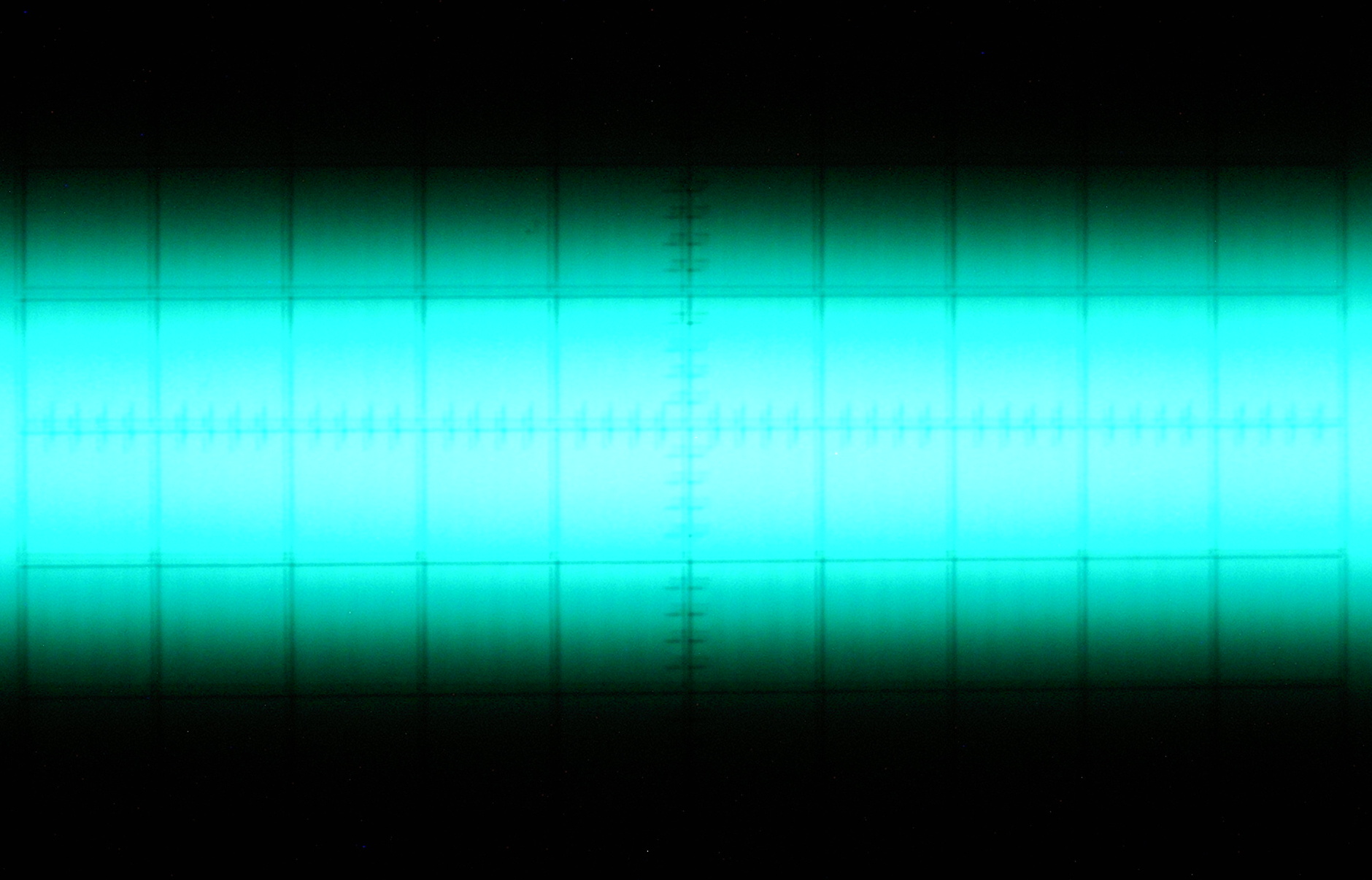

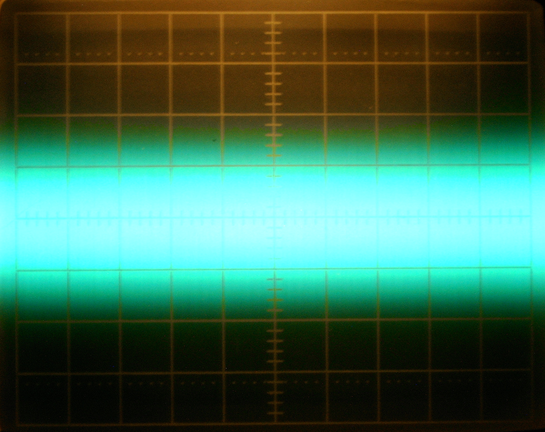

I've managed to solve the hum problem.
Here's a picture of the waveform with the scope set to 5mV/div, one has the scale on and the other with the scale off.
There are no op-amps, just a 15V zener connected to a 1.5mA JugFET constant current source.
Do I have a perfect white nose waveform?
It's difficult to tell. I know the picture with the scale off appears to have a periodic waveform superimposed on the noise but it didn't change with the position or timebase was adjusted, I think it's the way the phosphor is applied to the CRT.
What's the amplitude?
Interestingly the blur seems to be brighter at lower amplitudes; does this imply that there's some pink noise mixed in or is it the attenuation of the cable? I didn't use a compensated ÷10 proble.
I suppose a scope isn't the ideal tool for this, I need a spectrum analyser.

The question is what should white noise look like on a scope?
At first I thought that it should be a solid bar of uniform intensity at the same amplitude as the nose.
I've realised that the waveform displayed on the scope will be brighter at lower voltages because of the scope's roll-off and the fact that I used an uncompensated lead didn't help.
Is that correct?

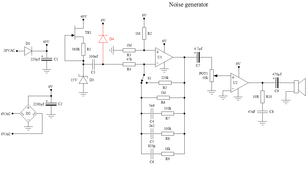

Here's the proposed final schematic.
One question: do I really need D4 (highlighted in red)?
I added it because I'm concerned a 15V transient, coupled by C3, might damage U1 or will R4 be enough to protect it?
U1 is a µA741.
U2 is an LM386.
I'll willing to make a bet it be OK without, but you've got little to lose by leaving it in.
Nice circuit. Does R2 need AC bypassing?
Yes, a capacitor across R2 or R3 would be a good idea.
