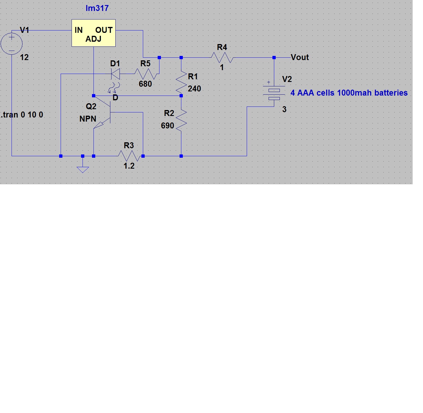

Was going with Li-Ion but for safety going with Nimh but need a small footprint charger. Contemplating using a lm317 but how reliable is this type of charger. YES there are chips for a smart charger but implementing as pcboard space is limited.
Found this schematic for a float charger but ??
any suggestions or comments concerning this schematic or similar. This is to be all smd but 1ohm resistors??
Trying to simulate so I have 3v on the battery which when fully charged is 4.8 but simulating a battery charger?

Hello there,
This circuit doesnt look like it puts out enough voltage to charge four AAA cells. The NiMH cells will require about 1.6v each for charging, maybe a little less than that depending on the cell. That means at some point the charger has to be able to put out at least 1.6v, usually nearer to the end of the charge period. At that time the charge current should be lower too, like around 150ma even though 200ma is supposed to be OK. That's so you can leave it charge overnight without burning up the cells.
The max charging current of this charger is around 500ma, so that's not too bad, and the 1 ohm resistor allows a tapered charge as mentioned above but you'd have to test it to make sure it tapered correctly for your cells.

USB puts out 5 volts. You need a bit more than that to properly charge four cells in series. So you'd have to do two at a time, or build two chargers to do four cells at the same time. I cant recommend this however, i would recommend using a small wall wart.
Just to note, you can calculate your required source voltage and required series resistance for a tapered charge as follows:
The three equations are:
R=N*(Vbegin-Vend)/(Iend-Ibegin), and
Vs=Vend*N+Iend*R
Pr=2*Ibegin^2*R
where
R is the required series resistance,
Vs is the required DC source voltage,
Vbegin is the beginning cell voltage,
Vend is the ending cell voltage,
Ibegin is the beginning charge current,
Iend is the ending charge current,
Pr is the power of the resistor R.
For example:
Vbegin=1.0 volts
Vend=1.55 volts
Ibegin=0.500 amps
Iend=0.150 amps
N=4 for four cells
Using those parameters we would get:
R=6.2857 ohms
Vs=7.1429 volts
Pr=2*0.5^2*6.3=3.15 watts
So we'd set up the regulator to put out 7.14 volts and use a series resistance of around 6.3 ohms. The required resistor power rating is about 3 watts.
Thanks MrAl
One possible issue is the 3w resistor. available in smd ? and room in enclosure? as well as heat. The enclosure is basically a sealed enclosure where the user inserts a wall cube plug into side of enclosure. Would really rather use a rechargeable button cell but then we get back to li-ion batteries which I would rather avoid. Presently have 4 - AAA batteries in series each cell is 1000mah rating. With pcboard I have very little room. With the last link I realize I need more voltage input than the USB outputs. I simulated in TINA and circuit seems to work. BUT the large resistor and heat??

Well, if you cant use a 3 watt resistor then perhaps you can parallel several resistors. Otherwise you'll have to lower the current or use a more complex circuit.
To lower the current to 160ma to start and 50ma to end you can use a 20 ohm, 1 watt resistor, and a 7.2v voltage source (regulated by LM317 most likely).
It will just charge slower.

The linked circuit charges 2 - AA 2500mah batteries in 5 hours but instead of 2500mah batteries I am planning on 4 1000mah AAA batteries so I need to calculate desired charging current.
Back to the drawing board but using a PMOSFET I hope I have no issues with heat as the linked circuit has?
