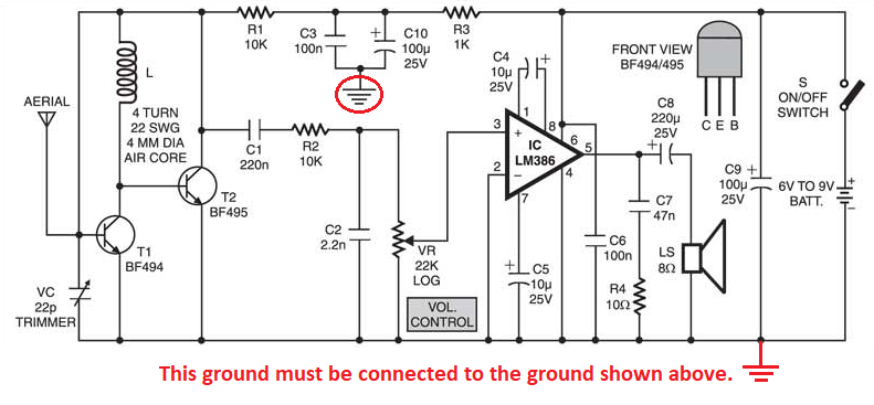

I am trying to learn a wee bit of electronics stuff at my old age (I'm 42). I am not too good with math but still, I am trying to learn a bit by doing stuff. Anyway, I saw a schematic for an fm radio and am trying to build one if possible. Now, bear in mind I have absolutely no real knowledge in electronics, so please bear with my rather stupid questions. In the pic, the switch is connected to the positive terminal of the battery, which I suppose is because schematics show conventional and not actual current direction, so I just have to connect the battery in the reverse direction right? Can I keep the orientation of the IC and other stuff the same or do I have to change them? Please do advise.
34JS0F1
The battery and switch are correct as shown - don't alter them. If you reverse the battery (and why would you want to?) the circuit won't work, and you'll kill the LM386.
However, that circuit doesn't seem much of a radio to me, FM or otherwise - if it works at all, it will perform VERY poorly.
The circuitry around T1 and T2 is unconventional.
Indeed. According to an LTspice simulation it will probably act as a ~250kHz oscillator. I don't see how that will do anything useful with an FM broadcast signal.
In which case it will probably act as a super-regenerative detector, which works tolerably well with wideband FM.

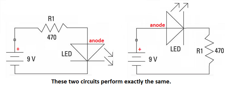

@ Nigel Goodwin: Sir, in the pic, the positive terminal of the batter is the one that is attached to the on/off switch. I thought electricity flowed from the negative terminal to the positive terminal, so shouldn't the switch be placed near the negative terminal? Like in this pic, which I got from the book Electronics All in One for Dummies, the positive of the battery is connected to the resistor and the negative to the LED so the current would flow the other way and the LED wouldn't work, would it sir?

Who cares which way the current flows. Simply make the polarities of everything correct. Make the anode of the LED positive like you show and the positive pin of each IC positive. Learn that the collector of an NPN transistor should be positive.

If I were going to build an FM broadcast receiver, I'd explore the possibility of using one of the single chip solutions or at least find a design that incorporates PLL frequency control.
If you're set on building the circuit shown, you have your reasons and I'll help if I can of course.
i think he might be better off with a real super-regen. when i was in grade school i built one that tuned the VHF air band. VHF air comms are in AM, but a super-regen could demodulate FM by tuning off center and doing "slope detection". http://www.ke3ij.com/superrgn.htm

@ audioguru: Sir, I beg you to forgive me but in the second figure that I posted, unless I know from which terminal of the battery the current flows, how am I to make sure that it flows from the anode of the LED to the cathode? I am sorry, but I think I am being unable to communicate with clarity what I mean. Somehow, I thought the current flowed from the terminal marked on the battery with a "-" sign to the one marked "+". So I figured an LED, if put in the circuit should be placed such that it's anode should encounter the current from the - terminal, through the LED and onward to the + terminal. I'm probably a bit mad for thinking like this but I can't help it. I apologize for making you feel frustrated sir, as I think my level of idiocy is something you haven't encountered before.:sorry: I thank you for the diagram, because I didn't know that info, nor the info about the collector of an NPN transistor needing to be positive. I suppose it is the other way around with a PNP one?

So really, in the first pic, I just have to connect the positive terminal of the battery to the switch and the negative to the other point, right?

ANODE means positive and CATHODE means negative but I found some backwards descriptions in a dictionary.
The polarities in the first schematic are correct and the non-off switch can be in the positive or in the negative side of the battery.
Recently someone posted that horrible "radio" schematic and said it did not work. I agree that it will not work because it is not a real FM radio.
Why do you think about the direction of current flow?? If polarities are correct (positive of the battery to the LED anode and negative of the battery to the LED cathode with a current-limiting resistor in series) then it works fine.
The schematic is missing the most important ground:
Yes, it makes no difference at all which side of the battery the switch is. On a personal view I would almost always put the switch in the positive lead (as most people do), as the negative is normally chassis/ground - but it makes no difference to the operation of the circuit.

@ audioguru : Thank you for the correction to the schematic sir. And ty for clarifying about anodes and cathodes.
