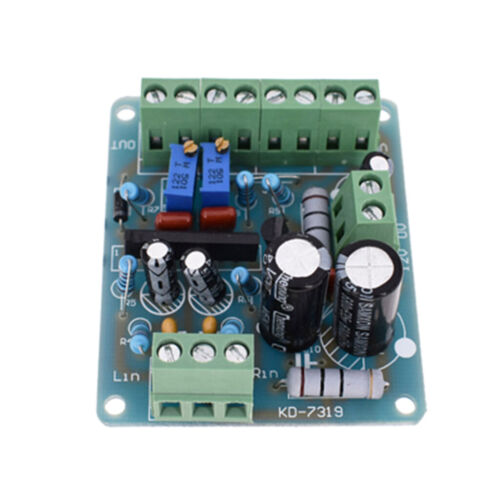

Essentially he needs a VU meter circuit, which would give a DC voltage output dependent on the audio level.
Here's one such example:
Yeah, maybe, but he's probably already spent enough money on this. He's already switched platforms, bought multiple modules, etc.

Please take a Screen shot and post it with your code. And a picture of the board you are using and connections.

From the description:
With it turned down, normal speech will only give about 200mV PTP change, so if you're running the module at 5V that's a change of about 40 counts (512 +/-20).
With it cranked up they say about a 1V PTP change, which is more like 200 counts.
The module looks to be a ripoff of the one from Adafruit https://www.adafruit.com/product/1063
