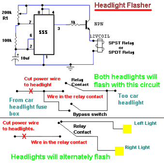

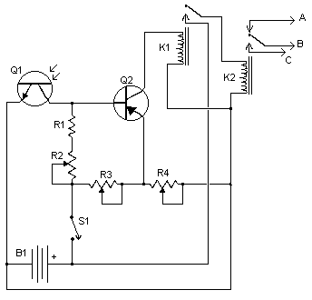

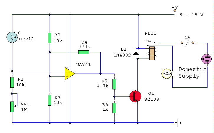

for the headlamp i found many types of schematic but i does not know which one to use it and definitely i have to add on sensor/ ultrasonic to modify the current circuit. these are the schematic i found on the web :
View attachment 40krvr1.pdf
View attachment 40KHZDET7.pdf

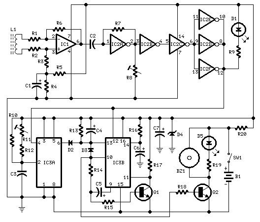

for the speed limit alert :
see this schematic
it works with a signal pick up from the speedo meeter (speedo meter has a rotating magnet to power the needle)
if you have a digital speedo meter you have to pick something up from the drive axel of the car
the main point is that you have a puls to feed the opamp that is speed related
sucsess with your project ;)

I'd test Tony van Roon's first. I don't think you need 40kHz detector circuits; you're not trying to detect 40kHz anything. The light from the oncoming headlights won't be modulated. Those two PDF circuits look to me like something you might use with an IR remote control. I meant ultrasonic object detection for your blind spots when backing up. There are a few threads about these things on this board. Sometimes they are called 'ultrasonic tape measures', except for this purpose they're even simpler: you don't need to display a distance, just light up warning lights on the dash if something gets too close to the rear of the vehicle while you're backing up.
Here's another idea for the speed alarm, this one based on a microcontroller. It would be reasonably simple to program alarms into the code and wire up an alarm and some switches to choose the alarm speeds. **broken link removed**
Robert-Jan's circuit has the advantage that it already includes adjustment pots and you don't need to program a microcontroller.
