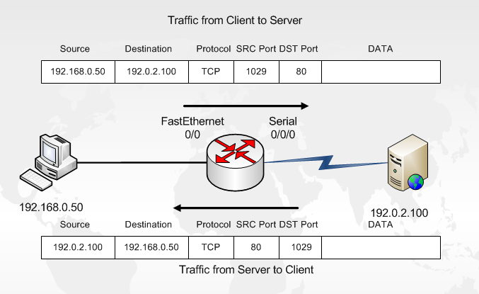

simple diagram, SRC=source, DST=destination

Hi.. as RC explained the process is very simple.
When your router sends a packet to CNN it puts a source port(random number) and destination port(80) then CNN web server replies with the same port number(random number) into destination port. When your router receives the packet it checks the destination port which will be the same (some random number) and this port identifies which pc requested this packet.
In this way both pc can ask for CNN but the packets random port number will be different and thus identifiable.
Hi SK,
Thanks a lot!
I understood you :)
There's something I don't agree with in the diagram you posted.
The PC's local IP Address is 192.168.0.50.
The PC's random port is 1029.
When the Server sends packet to the PC, the DEST IP Address of this packet should NOT be the PC's, but it SHOULD be the Router's WAN IP Address.
Say that the Router's address is 192.168.0.1 and the Router's WAN IP Address 12.34.233.2, then the Packet from Server to PC should be with:
Dest IP: 12.34.233.2 (NOT 192.168.0.50)
Dest Port: 1029
Am I correct?

Hi SK,
Thanks a lot!
I understood you :)
Dest Port: 1029
Am I correct?
Hi.. This diagram is just an example to show a packet contents e.g ip, ports etc.. this diagram is doing routing its not natting, so things go directly from ip to ip. Something like how your isp communicates with your router. Networking is very interesting and believe me its simple you just have to know few rules. Keep on Networking:).
