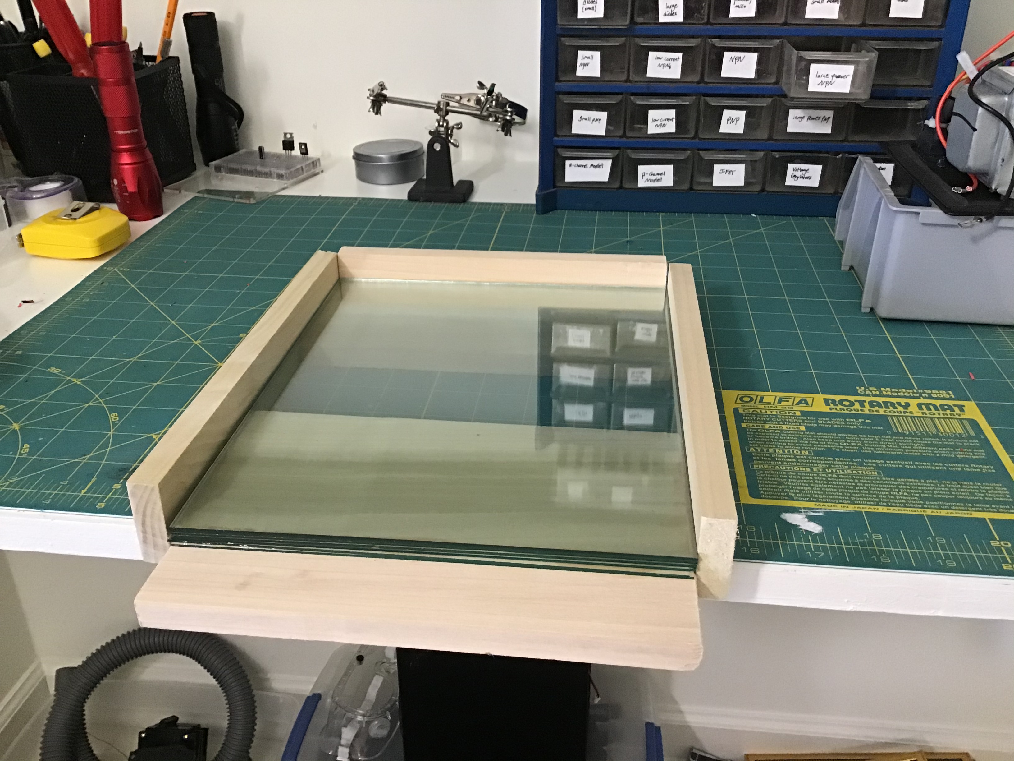

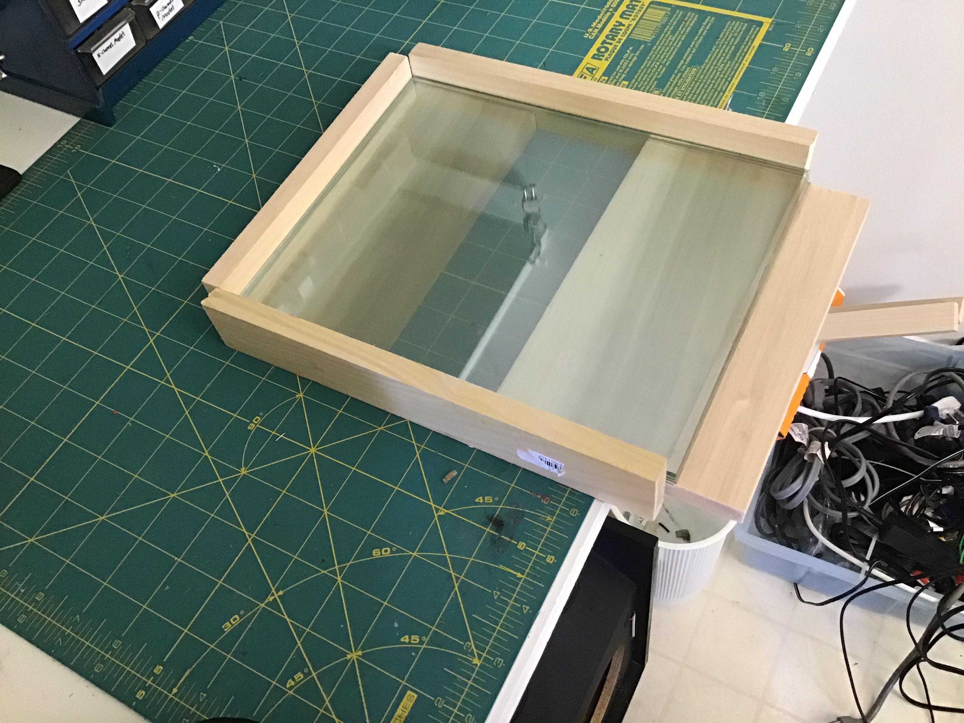

I don't know if that would be possible with the setup I have, but I:m adding a microwave fan to cool the plates a little a probably shave the edges of the aluminum sheets so its rounded and glue the edges to the glass. Do you think glue would be a good idea?
Glue around the edges would probably be good, but do try to find a way to submerge it in oil. It'll definitely help.
AHHH more construction. I stink at that, but ok I'll try, do you think the plates in a wood casing be fine in oil or would it damage the wood?
Great question, I'm not sure. I suppose it would depend on the type of wood and the type of oil. I don't imagine it would damage the wood though.
Not sure, but are you planning to leave a certain amount of the glass plate exposed around the edges of the aluminum? Your aluminum sheet with a frame of glass around it?
Wood for the most part is porous, with time the oil will saturate the wood and make a mess. You could though use a plastic container and make a wood surround to hid it. A container like this as an example any Walmart, Target, Dollar General type store will have them - https://www.target.com/p/rubbermaid...r/-/A-53696326?preselect=51097785#lnk=sametab
I’m not sure what you mean here, are you talking about placing the wooden glass plates holder in a plastic container? Or not using wood at all?
Yes I plan to leave about a quarter to half inch space on all sides except the terminals of cours.
Ideally no wood at all. Wood is not something people use to normally contain liquids. Whiskey and wine barrels are some what of a container but also have a certain amount of leakage, called the "angels share". They are also put under much more compression by the bands than any joint you can make.
Did I misunderstand something? I thought the OP was asking about using a wooden frame to hold the plates together, and then I recommended submerging the entire thing in a vat of oil (probably a plastic container).
Yes that is what I was talking about. Here is a picture of the beginnings of the wooden case and I can buy a plastic container later.
Guess I'm the one missing something.:) I thought he was talking bout a wooden container to hold the oil. Because fo the chances of flashover starting a wood frame around the plates to burn or char. Charred wood is carbon and probably conductive at high voltages and frequencies.
Sorry for the confusion, Wooden casing in plastic tub is the objective.
