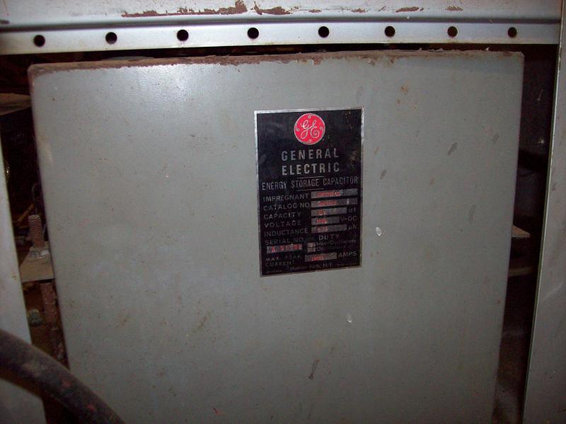

Any protection device that works and protects the transformer is good. I have very good luck with 30 tunes of #14 solid copper insulated house wire on a 2" diameter choke toroid. I use a 120vac variac for speed control for the AC motor spark gap fan. I use fans from a vacuum cleaner. I did experiments with secondary coils in parallel 2 & 3 coils wound over the top of each other soldered in parallel. I tested a 950 turn secondary spark output was 20" long, same 950 turn secondary with 2 coils 950 turns each wound over top each other produced 21" long sparks, and 3 coils wound over each other produced 22" long sparks. Multi secondary coils are not a big improvement but it works. I always thought it would be cool to find a way to discharge my big capacitor bank though a 12 ft long TC spark. I have 3 caps in parallel rated 5000VDC 18,000. amps each = 270,000,000. watts. The cap bank is amazing to play with they will vaporize 6 ft of 1/8" diameter steel wire the BOOM is as loud as a high powered rifle. I use to discharge the cap bank over and over on 4th of July police would come to see if I was shoot illegal M-80 firecrackers. LOL. I got several free used airport runway lights once I discharged my 270KW cap bank through the bulbs they made 1 BIG flash and a BIG explosions, and totally vaporized each light bulbs, the metal base & glass were gone.
