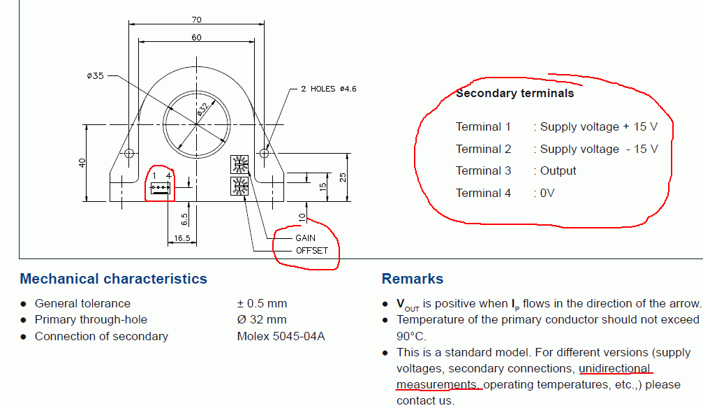

Looking at the data sheet, the sensor has an (opamp) buffered output, with adjustable gain and offset. It will not care if asked to drive an offset current of a couple of mA.
I see that it operates from +15V and -15V, so if you are going to build your own offset circuit, you should be using these supplies to shift the output; not the 24V supply which is likely very dirty...
I notice that the maker of the sensor can sell you one with a unidirectional output. Why not just buy the correct sensor from them in the first place? Also ask what is the range of "zero" and "gain" pots. It maybe that you can shift the output by just moving the pots.

I have attached the data sheet in the message in 15 and specifically i am using the following part number HTA 400-S
