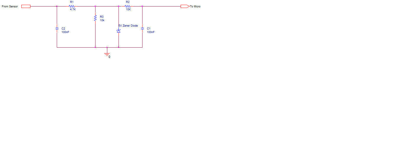

a. I have attached the circuit from sensor to ADC of micro this part of the circuit is part of PCB and unfortunately i cannot modify this additional circuit i have to interface with this.
b. The data sheet of the ADC of the micro.
c. The data sheet of the sensor.
The micro works on 5V power source. I have programmed the ADC for 12bit. Now i want to read the sensor voltages from -4V to +4V which are below the 5V source. Please also suggest me some circuit in case any new sensor range is from -10V to +10V or any generic range.
Thanks in advance.
I had little difficulty attaching the docs, but finally i could do it.

Don't ask me.... +15 gives 4.6v and -15 gives 0v...
Is the output of the divider connected to a PIC's ADC input.?
If yes, then its the PIC's internal clamp diode thats sinking the -Vinput range.
Can you post the circuit showing the resistor values that gives +15 gives 4.6v and -15 gives 0v.

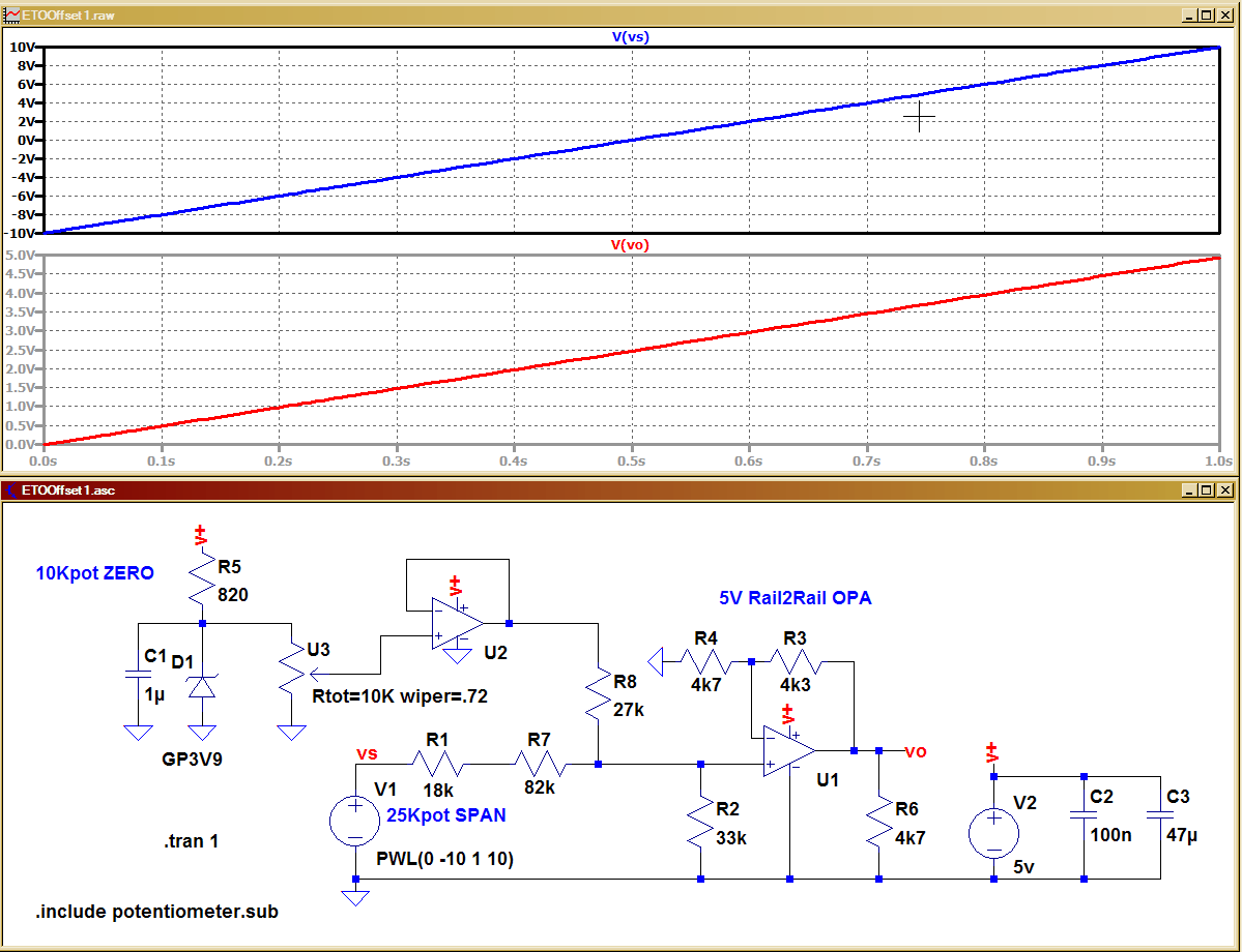

hi e78,
I would suggest a rail to rail OPA configured to level shift the +/-10V signal to say 0V thru +5V, assume that +2.5V input to the ADC is equivalent to 0V input.
The PIC program could then output the corrected +/- ADC values.
E
EDIT:
This is one option.
I built the same one as the one posted!!! I didn't connect pic!! I connected to an MCP3002 then to the pic.. I was quite surprised with the result!!
