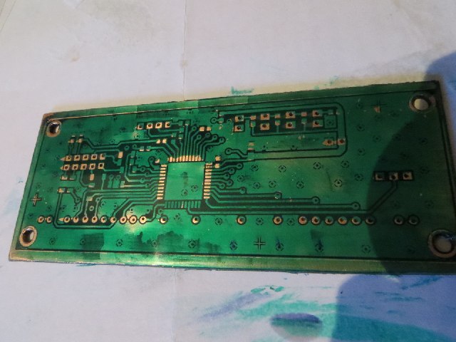

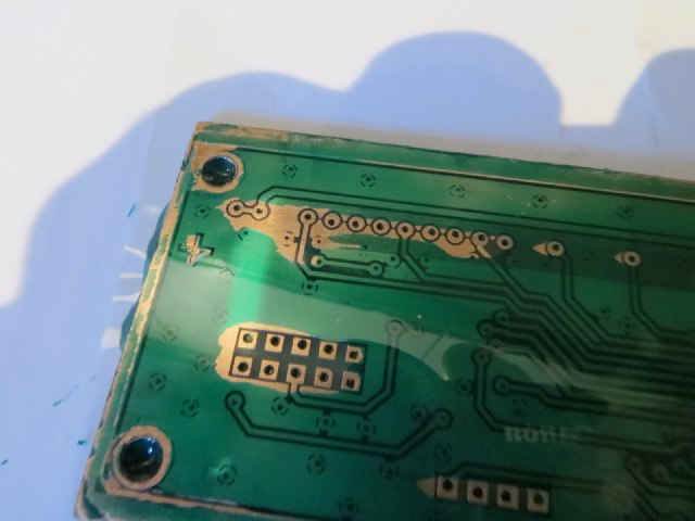

I've attached some photos to illustrate what I'm talking about.

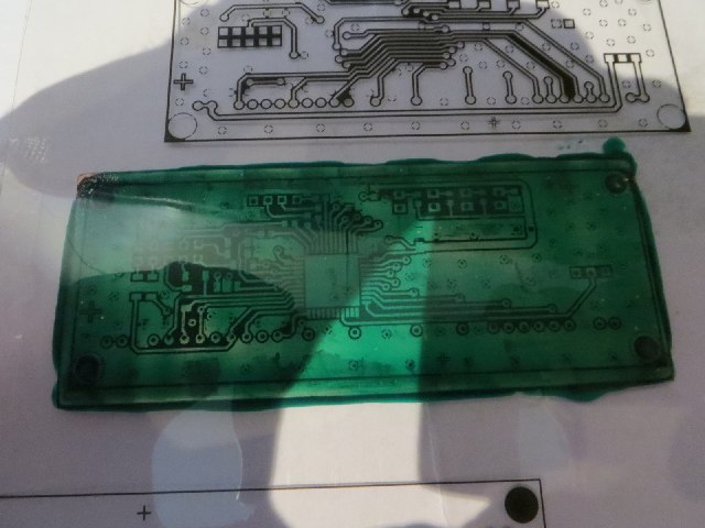

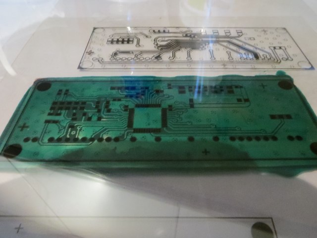

I have discovered there is quite a difference in how dry film photoresist behaves, depending on how old it is!
It wasn't the wax causing the problem, well it was a little bit. What I've discovered is the old photoresist I was using which is quite old and has gone a pale violet colour, works really well if it's wet. It loves water and a good hot laminator.
The new photoresist I've got is much fresher, and it's blue, much bluer than the old stuff ever was. It likes slight dampness, and a lower temperature laminator. With a completely dry board, I was able to re-position the film, but on the other side I tried breathing on the board before applying the film, and it stuck down quite well before even putting it in the laminator. So now I'm having to wind the clock back in my dry film process.
All this took 5 attempts to find out. Wasted quite a lot of photoresist, with two sides, glad it's a small board.

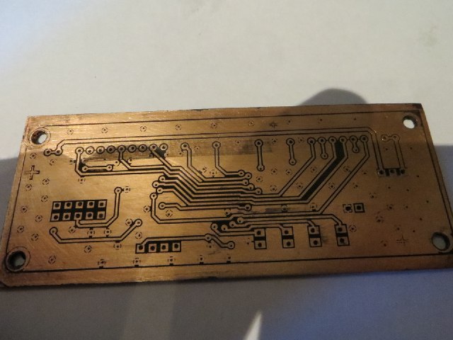

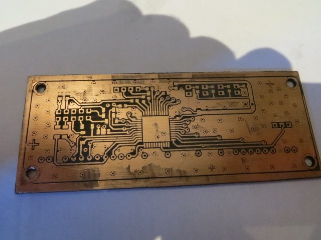

So the next thing, etching, again didn't go right. Thin copper left between the tracks in some places which I couldn't see until way too late. I've had it before with this copperclad so it may be a problem with the cheap crappy stock I'm using. Of course I only found this after I'd stripped the resist off and done my short/open tests. Colouring in the tracks with a Sharpie and sticking the board back in the ferric chloride cured that. Harder to clean though.
Something that went really well and I'm really pleased with, all the signal vias are conducting, all the pads with connections on both sides connect through the board. Can't individually test the ground vias but I put lots in to make up for any duff ones. So the wax has done a good job there. Last board I did wasn't tented properly on some pads so the plating got etched out.

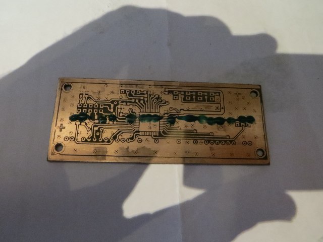

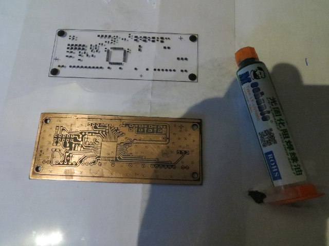

The solder resist (the main point of the whole business with the wax, in case you forgot) went on really well, no problem with it going through the holes, except the corner ones which I took the wax out of. No more air bubbles than for a single sided (therefore, not pre-drilled) board.
However, more trouble with that, over-exposed the component side so some pads have resist on them, and the board mustn't have been clean enough with all the messing about as some cured resist peeled off with the cover sheet.
So I just need a better hole filling material and some better methods...
it's possible there's some kind of oxide or something on top of the copper causing bridges. try cleaning the copper with steel wool before applying the etch resist
Hi Unclejed
It would be good advice (I believe steel wool is especially good for removing oxide) but, the original copper laminate has already been cleaned extremely thoroughly, then soaked in caustic soda (Lye), then pickled in hydrochloric acid, before being plated with a layer of fresh copper, so the original laminate doesn't have a cleaning problem. On this board I then plugged the plated holes with wax before applying resist, which worked though it made a horrible mess, so got a very very thorough cleaning. The un-exposed resist is then removed with a strong solution of washing soda and gentle brushing, which would also tend to remove any last trace of wax.
The copper which is left, giving me a problem, is like a thin film of copper, almost invisible until after you've seen it. I've only ever had it with this particular board stock (the previous time was before I could do any TPH) which is why I think the composition of the copper may be uneven since it occurs in narrow spaces as well as large areas. It seems ulikely that it's due to any residual resist because the copper goes pink as soon as it's in the ferric chloride. I do agitate the boards as much as is possible in a takeaway food container.
An interesting effect I have noticed is that in places the traces have a sort of "double edge" where the copper I've plated on doesn't etch at the same rate as the original copper.
I think I just need to etch them a bit longer.
it's possible that the copper you are plating onto the board is a)unevenly deposited on top of the original laminate, so that there are areas where the copper is thick in some areas, and thin in other areas (which can be caused by hydrogen bubbles on the cathode surface, or uneven current flow between the cathode and anode) or b) may contain impurities from the plating process, such as traces of iron or nickel, or traces of the "carrier" salt that was mixed with the water. the surface of plated copper is also very rough compared to the original laminate, and may etch unevenly due to to variations in the surface roughness. is there any particular reason you are trying to add more copper? also, if you are going to continue trying to plate the laminate, make sure you clean the laminate with alcohol to remove traces of oil...

Filling the holes has 2 purposes.
Primarily, it's to prevent liquid epoxy solder resist going in the holes when I apply it. (see post #1)
Secondarily it's a backup means of preventing holes being accidentally etched if the resist doesn't cover them properly.
