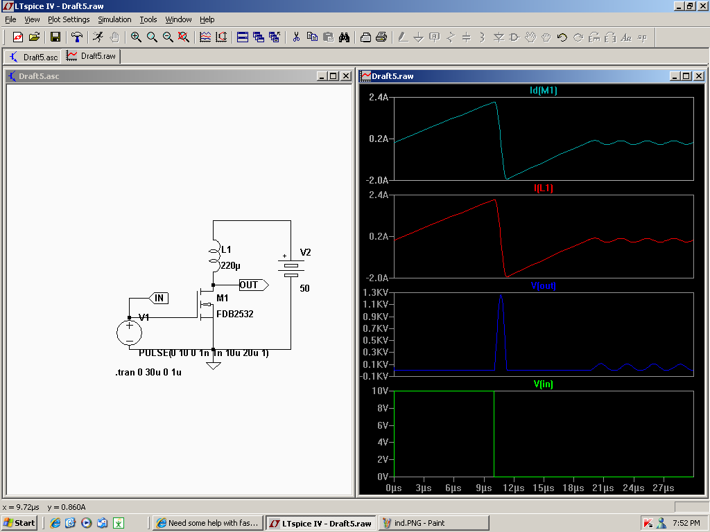

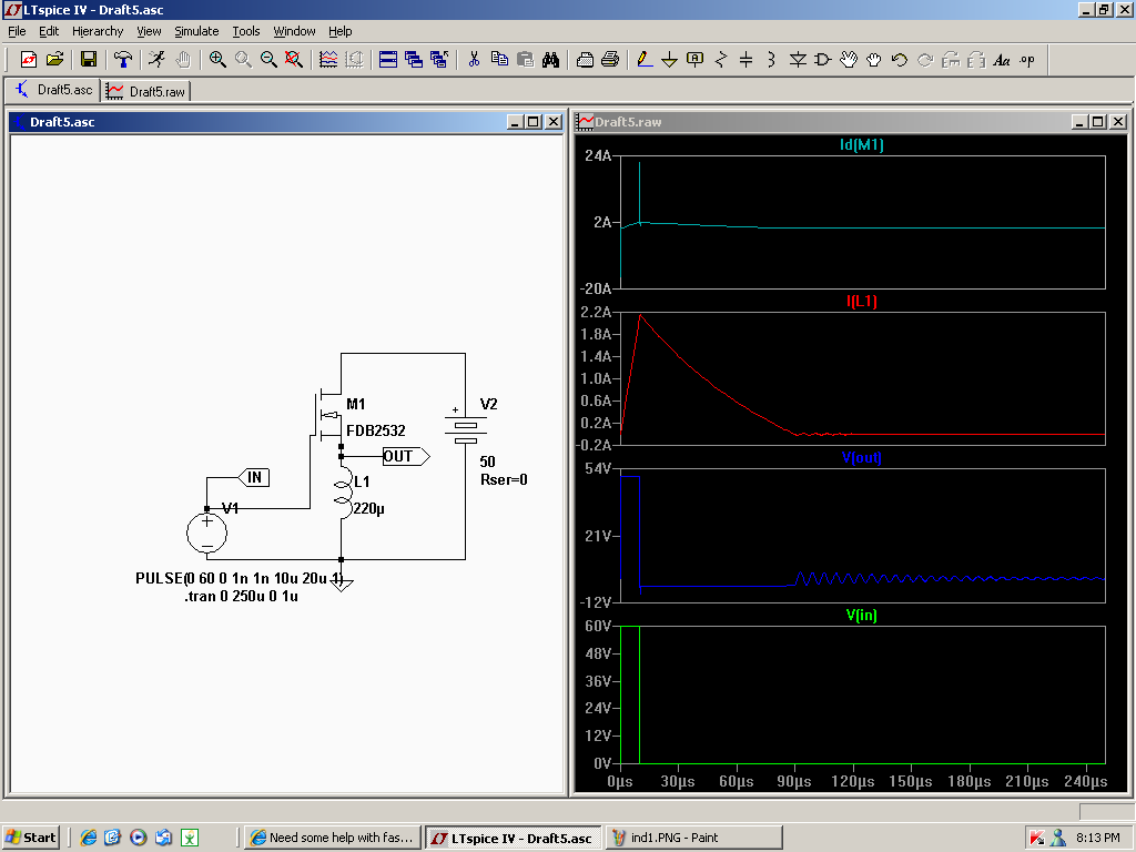

I haven't found a data sheet that looks like your part. On the surface it looks like it would work as long as you have pulses comming in. Most bootstrap drivers won't work for dc. I'm not sure what you mean by removing the MOSFET from harms way of any load. I think we are missing something here. If you are worried about the inductive "kick" at turn off that is what the diode is for. See the attachments. Note the very high voltage without the diode. In the other configuration the "body diode" of the FET "catches" the inductive kick (but not as good as the fast diode).
Ron, plot Vg-Vs in your last circuit. Remember that the max Vgs for most FETS is only ~20V. To reflect reality, you would have to float your input voltage source, and connect the + end to the gate, and - end to the source (Out)...
