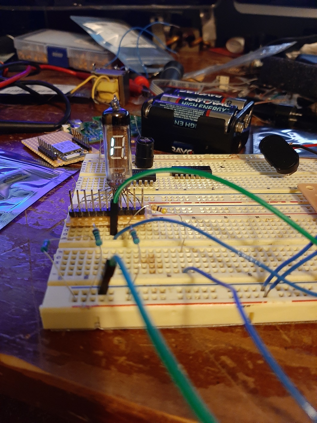

I been playing with some of these, kind of cool got about 3 weeks till the driver comes in from china to
make my board.
I got 20 of them this is my tester im going to make 8 drivers
out npn pnp pairs
These are VFD IV-3A USSR Tubes
