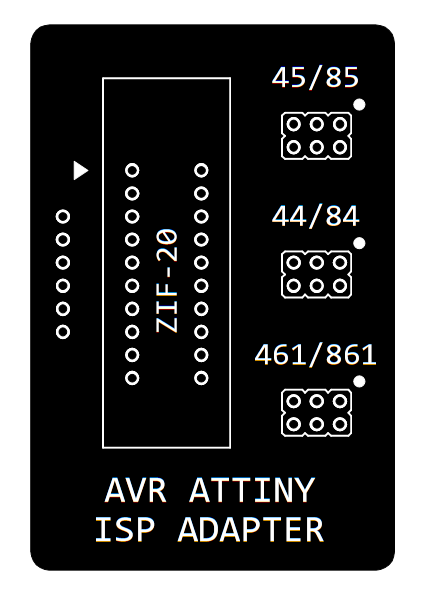

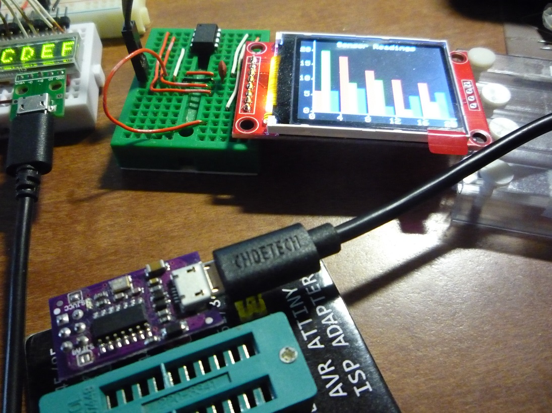

BTW, Bob. You might look into sampling some of the 8-pin, 14-pin, and 20-pin chips supported by the ATTINY Arduino core. You can program them from the Arduino IDE using an Arduino and the "Arduino as ISP" sketch or one of those inexpensive micro-USB "avrisp" boards from China (**broken link removed**). Unfortunately, I can't guarantee it'll work with your Mac...
I made a simple programming adapter board with 20-pin ZIF socket for a few of the more common ATTINY chips (see below)... it also plugs into my PICKIT3 to program 8/14/20 pin PICs...
