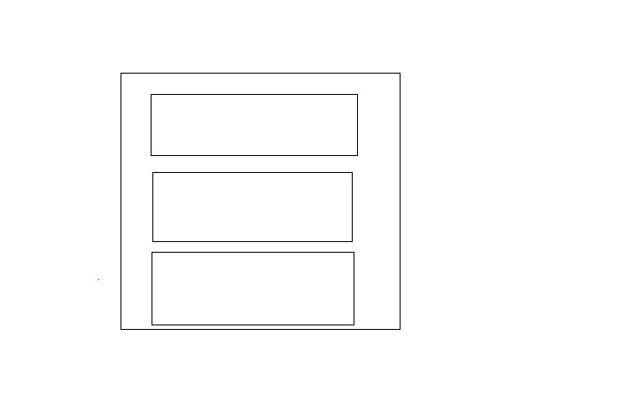

Board size by prototyper is "50mm X 50mm max", so 3 on a board with clearance to cut them out by hand and also single board separate files,

3 of the same circuits on 1 board. Board size 50mm X 50mm spaced so I can cut them out by hand.
1 separate single circuit board size 15mm X 40mm I can use as master incase I need mods later.
No restrictions except 3mm hole on corners of board including on 3 on 1 board so it will have 3mm mounting holes on each piece in corners when I cut them out.

And finally (I know I'm asking a lot, and I really appreciate this), do a 3 on 1 board thats 50mm X 50mm so I can cut them apart
after they are etched.
Need the single circuit board also so I can use as master and play with it in Eagle to get practice.

3 on 1 board something like this:::
Board size 50mm X 50mm.
that is the size board maker will use,
so I might as well use the space to put a few of them on there.
