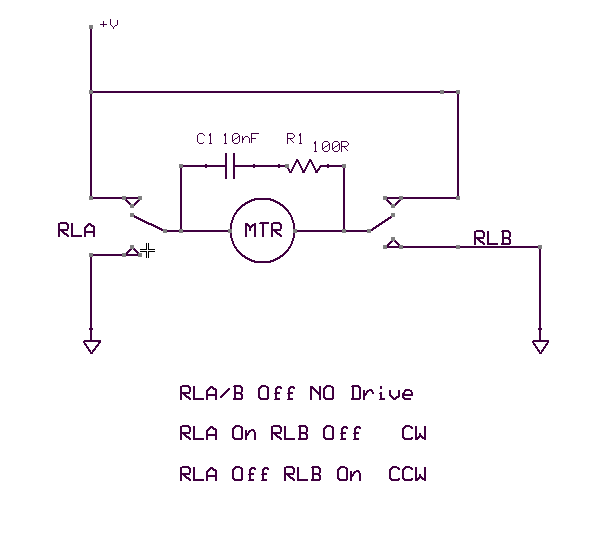

That circuit requires bipolar (+V and -V) power supplies. In post #1 there is a single power source, so you would need a full H bridge.
This is why I asked about the motor power requirements. A 555 makes a good-enough half-bridge driver, so two 555's will do the entire circuit - IF IF IF the motor current requirement is below 200 mA.

Nope i have geared motor that spins around 30rpm voltage 12v current around 300-400 mA
The start up current will be 2A. (don't know but much higher than 0.4A)
If you reverse the voltage on the motor before it stops the current will be higher yet.
