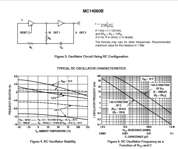

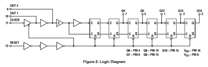

MC14060 or CD4060 is a 14 stage counter and oscillator.
Check my math.
Ctc=0.01uf, Rtc =100k, Rs in the 220k to 900k range. Adjust the value of Rtc to get the right frequency.
Q14 output should be at about the right frequency. I would drive a relay that reverses the motor.

I like the idea and i think i have that counter in my workbench but can you be more specific and send me a schematic with the transistor i sad and the whole conections it will be really helpfull

So i find the datasheet of the ic and i see what to do i need 2 resistors in series from pin 11 to pin 10 and a capacitor from the rtc resistor to pin 9 and i will hook up an led to maintain the duticycle and i will put a potentiometer ob rtc
