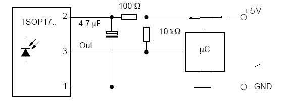

ive tried my TSOP1738 receiver.
TSOP1738 gives me an increase of about 10cm...which is a total of 45 cm only.
I am using a high power transmitter operating at 100mA(its max rating) at 38khz.
i am wondering how can I boost the distance up to 20feet?Anyone can help me in this?i even tried boosting the transmitter to 200mA and the distance remains the same...

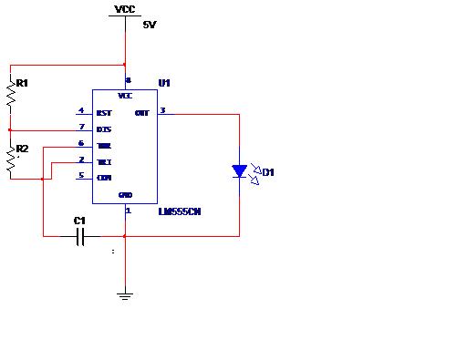

my circuit is fairly simple
i used a normal 555 timer circuit with R1=6900,R2=5100 and C=2nF to get it working at 37.88khz. I tried different currents for the emitter, 90~100mA, and also up to 200mA but the distance remain the same.
I am not sending a burst of data and i dun that.
Well you don't have a series resistor on the LED, so it's rather nasty to both the 555 and the LED!. To increase range you need to use a driver transistor to increase the power to the LED - it's usual to pulse than at about 1A or so, but ONLY with a very low duty cycle - this easily gives about 30-40 feet range.
ooh...means that i have to amplify the current from the pin3 of the 555 upto almost 1A?im not very good in transistor and current amplifying cicuit,thats why i avoid,using it...can suggest or show me any circuit?
if its like that, i will have to re-adjust my R1 and R2 values, is 10% duty ratio ok?at 38khz?but the max ratings of the transmitter is 100mA......just afraid it will blew up the LED....btw, what is the current supplied to tv remote controls(powered by only 3V, can it reach 1A?)?

Your 555 circuit doesn't have a supply bypass capacitor to supply high current to the 555 and to the IR LED. Maybe that is why they didn't burn out without a current-limiting resistor.
If you don't send bursts of data like the datasheet says to do then the AGC in the TSOP reduces its gain. Then its range will be short.
Are you trying to sense a reflection from an object that is shiny and white or from a mirror that reflects perfectly? Then it will work.
If you are trying to sense anything else then you need a camera or something different.

Check my PIC tutorials, the IR hardware shows how to connect the IR receiver and the IR LED - you could use the same LED driver with your 555.
TV remotes commonly pulse at 1A or higher, they rely on a good sized electrolytic to provide the high current pulses, and short bursts of IR - with plenty of time for the capacitor to recharge in between them (my IR tutorial does the same).
Basically a TV remote sends coded pulses, then a completely blank period, then repeats again - this means the IR LED has time to cool down between data streams.

A bypass capacitor of about 100uF should be connected across the power supply to provide the high current for the 555 and for the IR LED.
Are you sending bursts of IR pulses?
hhmm..ok..but how high will the current be?i will test it out.later...
i am just sending a square wave which is tuned to 38khz, its that consider burst of pulses?and my current duty ratio is aobut 50%.
