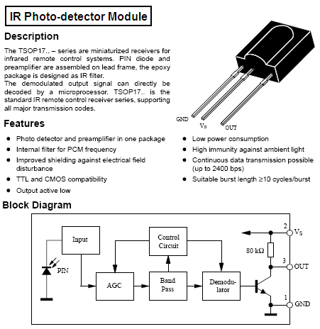

If you are transmitting data, not voice or music, then why not use the simple IR transmitter circuit in a TV remote and a TSOP IR receiver IC? They have a range of about 10m.
Easily that, when I was testing my IR PIC tutorial circuits they worked fine the full length of the workshop at work, something like 18 metres?.

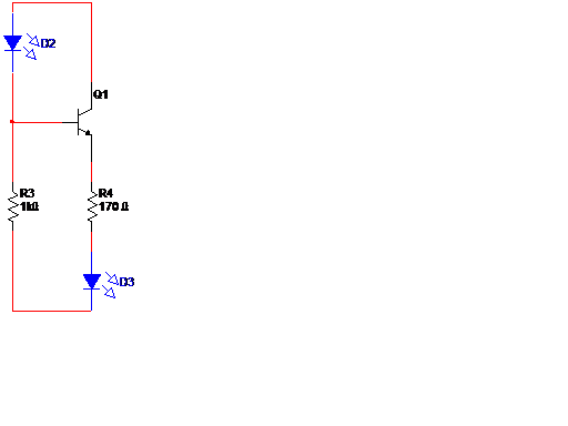

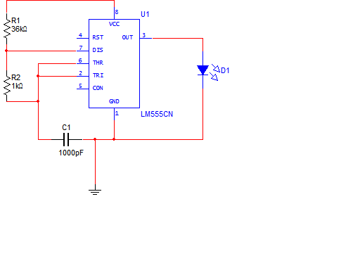

this is the IR transmitter and receiver that i constructed:

You don't have a current-limiting resistor in series with your IR LED. It will burn.
The TSOP1738 is a complete IR receiver. It needs only a 5V power supply. Get its datasheet from www.datasheetarchive.com .
Nigel also has them in his PIC tutorials.

Of course. Use a TSOP IR receiver IC for very long range. Your IR receiver circuit is just a single emitter follower transistor with hardly has any gain.
are you saying that the problem that caused my IR circuit could not work in long range is because of my receiver circuit? so u suggest i replace the normal IR detector with TSOP into the circuit or only plug the IR to the PIC? sorry to bother as i am a noob in electronic stuff.:(
edited: is the TSOP compatible with other ordinary 2 pin IR transmitter ?
Yes, your receiver didn't have any gain. A TSOP receiver has lots of gain and many other features.
The TSOP is tuned to an IR carrier frequency. The TSOP1736 is tuned to 36kHz, the TSOP1738 is tuned to 38kHz and there are also other carrier frequencies available. Just tune the frequency of your 555 oscillator in your transmitter to the same matching frequency.
thanks for the reply. TSOP 1738 is being tuned to 38kHz, meaning i must tune my 555 timer exactly 38kHz or is there any tolerance? can u show me the formula to tuned the 555 timer, as i wanted to compare with my formula. thank you
The datasheet for the TSOP IR receiver shows the width and tolerance of its bandpass, and the datasheet for the 555 shows the formula for its frequency.
I think the resistor values in your 555 oscillator are too low, and the capacitor's value is too high.
You should add a current-limiting resistor in series with the IR LED so that its current does not exceed the max spec'd on its datasheet.

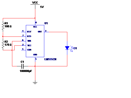

i have reconstructed the circuit, is the value of the resistors and the capacitor ok for this circuit?

your LED doesn't have a current limiting resistor. (hmm, seems like I've heard that before...). it's hard to say which will burn out first - the 555 or the LED. also, you left rst floating, no cap between con and gnd and no decoupling caps. other than that, it's fine.

It's just a standard logic level output, you can connect it directly to an I/O pin on the PIC - check my tutorials for exact details - it's ESSENTIAL to include the decoupling capacitor and resistor in the power feed to the receiver, or you get seriously strange problems!. There's no programming involved with the sensor, only of the data you send over it.
You can't really do anything to the receive side to increase range, you need to increase the transmit power - multiple LED's, higher power pulses, more accurately focused (using narrower beamwidth LED's).
