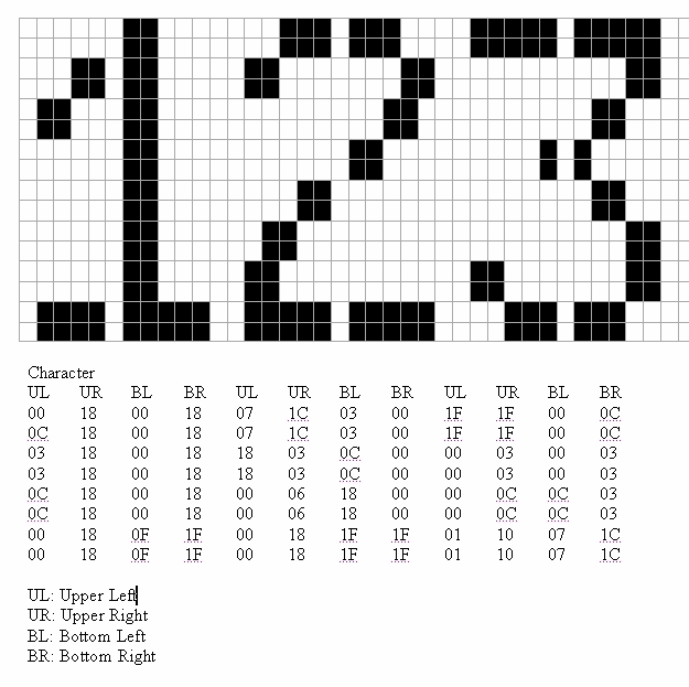

I need more than eight user defined characters in one LCD screen.
How can that be done using the HD44780U display controller?
What I want to do?
Combine four adjacent (5*7 dots) characters + cursor to one big number. Characters 1 and 2 from lines 1 and 2 will result in one big number.
I thought of following steps:
1) make four user defined characters (1 to 3) for a big 1
2) write those characters on the display
3) make four user defined characters (1 to 3) for a big 2
4) write the new characters in the display, and so on… …
With the above sequence I thought I will end up with a large 12 on the display but:
The first written big number 1 is overwritten by an even big 2 so I end up with 22 instead of 12.
With a delay between the two write sequences I clearly first see a big 1 and then a big 22.
So the display don’t copy the data of the user defined characters into DDRAM but the address of the user defined character.
Thanks for any inputs… …

This is not how character based displays work. If you print the character a number of times and then change the definition, the characters on screen will change. The only "display ram" is the ram that contains the character numbers (1 byte per character location), there is no pixel data type ram.
Multiplexing (described as pwm above) the display may work but I think it will be very faint. Changing the contrast may improve things.

Hi Eric,
I can't implement your solution since I have to treat each sub-character as one item.
You can't say user defined character 0 (udc) is segement a, udc1 is segment b and so on to udc7 is segment h.
In your example is udc1 segments a, c, e (upper left character); udc2 segments b, g, f (upper right character) and so on. That way I need more than 8 udc's for all possible combinations.
Or did I misunderstand your example?
Thanks anyway to help me out on this one :)

Hi there,
Sorry Eric but I think I don't understand what you mean by:
ericgibbs said:
... it would be necessary to create the symbols within the program in real time...
I think I'm already doing that since I modify the user defined characters (udc) as I need them. Is this what you mean by "in real time"??
Problem is that, like Mike already mentioned, the address of the udc is written at the DDRAM addresses not the data of the udc itself.
So when I change one udc all DDRAM locations using that udc changes at the same time :(:(
I think your PIC simulator doesn't react like a real HD44780U does or I'm still missing something :(:(
I'm using 8051 system en program in assembler.
Attached a screen shot of the "Big Font" I planned to make :)

hi mcs,
Do you understand the Basic language, I know there are many variants, but I will, if you are interested, post my draft copy of the Oshonsoft basic program I have been using for the special characters.
The OS LCD sim does respond in this application as per the HD44780.
If you examine my program, you will see for each digit, before its written to the LCD, the special character pattern
is loaded into DDRAM, it is then called using that special characters address.
I write the digit to its designated location on the LCD.
eg: consider 6 digits, representing the real time of day,
if I want to display the minutes 'tens', the program gets the digit for the time counter,
creates the special char pattern for 4 of the LCD pixel blocks, it then writes these 4 spec chars to location number 5 of the LCD.
Remember when you do it this way, only 4 LCD pixel blocks, require a new spec char, before its written to the display.
When dealing with these LCD's its a good idea to only re-write a digit to the LCD, when that digit has changed from its previous value.
There is no point in refreshing the whole display, if only one digit has changed.
Let me know what you like to do?
