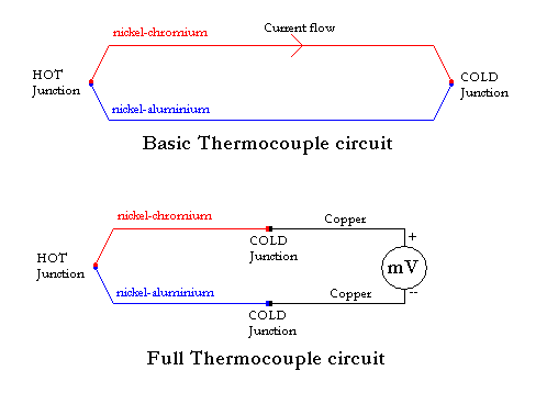

where is located to "cold" end of the thermocouple?
A thermocouple junction is formed by connecting two different kinds of wire, such a construction will leave you with the two wire 'tails' of wire to connect to something in order to complete the circuit. These two 'tails' could be connected to each other (as in my first sketch) to form the most basic circuit but this connection will form a junction identical to the first one. We refer to one as the 'hot junction' and the other as the 'cold junction' simply so that we can differentiate between them, it actually makes no difference which is which until you make one hotter than the other - the 'hot junction' !
When the two junctions are at different temperatures there will be a small current flow through the circuit - this is the Seebeck effect. **broken link removed**
To make the circuit into something useful we must connect an indicator in series (as per the second sketch) but this now gives us three junctions where different metals join, each trying to generate a voltage. If the two new junctions (where copper wire is used) are at the same temperature then the voltages will cancel out (the law of intermediate metals) and leave us with a voltage proportional to the difference between the two wires, nickel-chromium and nickel-aluminium for example.
I would suspect that the cold junction(s) will be in the plug, allowing the controller to measure the socket temperature and compensate for this.
Wow ! ... it's easier to understand than to describe :!:
