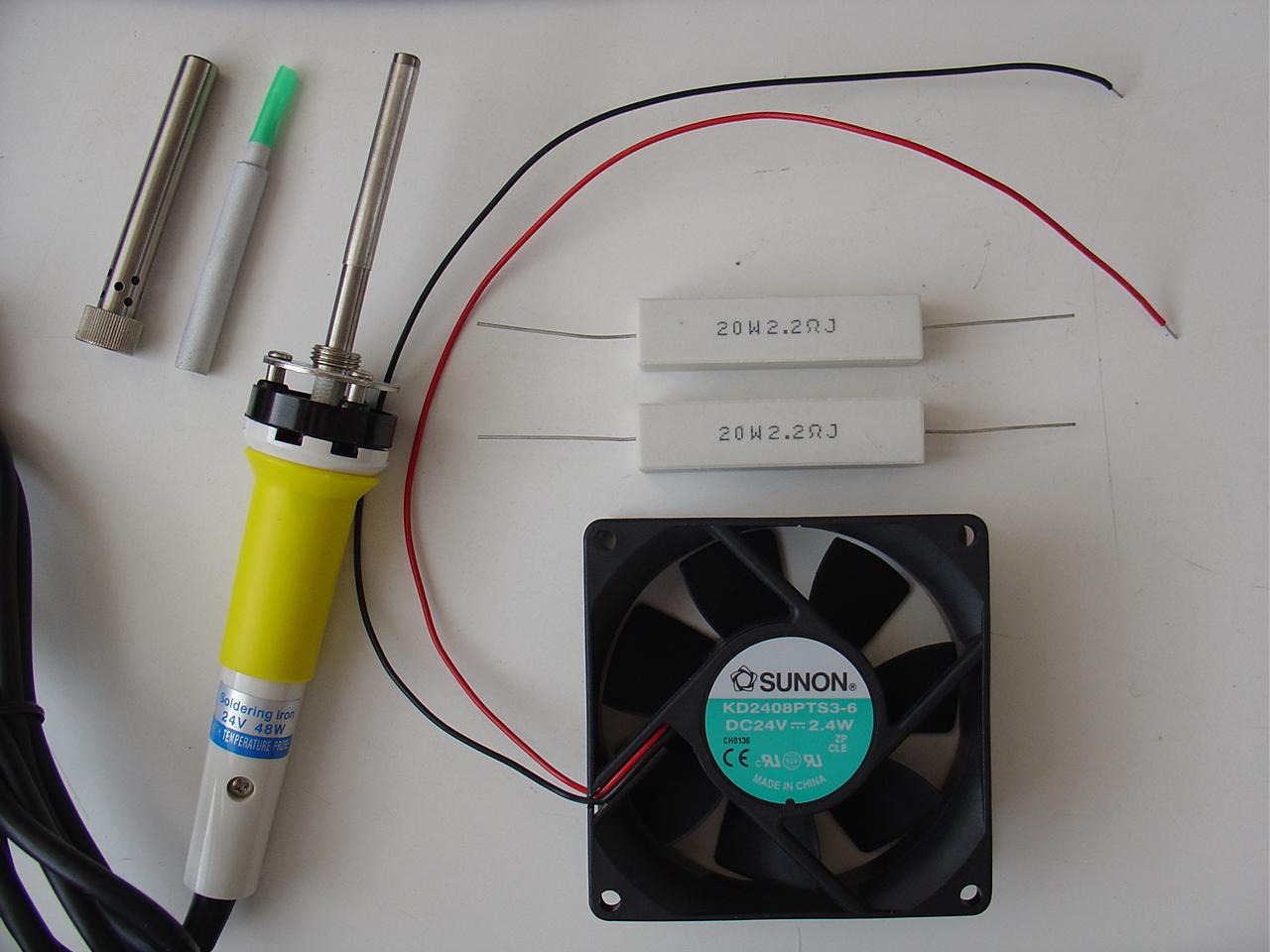

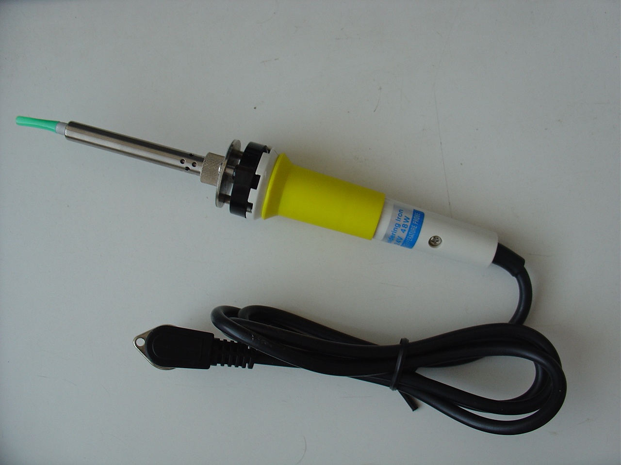

I don't have suitable soldering station and because SMD PCBs are so easy to make with Press-n-Peel I have decided do get new, temperature controlled soldering station. I was looking for one with basic functions (just R/G LED indication and one potentiometer) but all costed $60+ and I am not willing to spend so much!
Then I realised I can build my own, for 1/3th of the price, so I bought $15 24V/48W Pro's kit spare soldering iron, with thermojunction temperature sensing.
The thing is I am looking for a way how to correctly feed this thermojunction output to the PICs ADC (16F88 or 18F1320 - to be decided). It's output is at 0.2mV @ room temp and approx. 50mV @ full power (don't know exact temperature). I was thinking of single non-inverting OPamp solution with Gain=50. Is this OK? I am not an expert when it comes to OPamps (eg will Offset voltage be a problem?).

Thanks, but I want it to achive ~5C temperature accuracy.
BTW: The two PSUs are connected in series resulting with 24V/2.2A power output. I placed two 2.2R /20W resistor to the 5V rails as a pre-load.
The PIC runs from +5V rail and is using 2.5V external voltage reference.

Oh and i have a question.Whats cooling the 2nd PC PSU? There is no fan on the other side.Hope you keep it cool enugh.
I am planing to do calibration at 0, 25 and 100 C (Because I don't have a thermometer) and I hope it will show me it's temperature/voltage characteristic. What I wanted to know is how to use the OPamp, standart non-inverting or differential?
The PSUs don't make much heat, so the cooling will be sufficient. Originaly they were cooled by 6*6cm FAN @12V, now I am using 8*8 FAN @24V.
This can't be a simple thermocouple - a 'K' type thermocouple (nickel chromium / nickel aluminium) would give 12.2mV with 300 degrees C difference between hot and cold junctions :?
Is this "thermojunction" a thermopile of some sort (a stack of thermocouples in series) or could it be a resistance thermometer? An RT could have a resistance anywhere from a few hundred ohms upto several k and measure the same regardless of connection polarity, a thermocouple will be only a few ohms and read differently when the meter leads are swapped to reverse its polarity.
If it is a themocouple/thermopile then you will have to measure the cold junction temperature and compensate for it or maintain it a constant temperature -- it's the difference between hot and cold junctions that generates the output. At ambient temperature (hot and cold junctions at same temperature) there will be zero output.
ps. sounds like an ace project - consider a write-up for the 'Projects' forum ?
Mechie, maybe I accidentally measured 5mV at 160C, I don't know beacuse I don't have proper equipment. When I was exploring the Iron, I measured ~4ohms and 0.2mV @ room temp, the resistance IS different if I swap the LEADS. Do you have more info regarding thermocouplers? I would love that.
