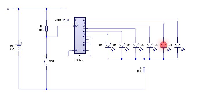

the attached circuit is a hardware version of a digital dice - uses the length of a button press to get a ‘random’ value. we just need to work out a random input and we've got you a solution.

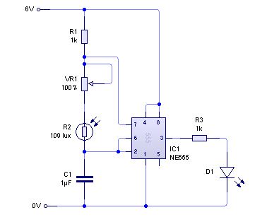

This is an example of a 'light to frequency' circuit - it would need modification so the frequency range is correct but after that you could put the LDR near the boxer in question and use his shadow to provide your random interval.
You would need to put 555 output (where the LED is) to the EN input of the counter in the previous circuit. And in the previous circuit you need to connect R (reset) to 3 (so the counter just flips between 1 and 2). Another 555 astable would be needed to provide the clock frequency

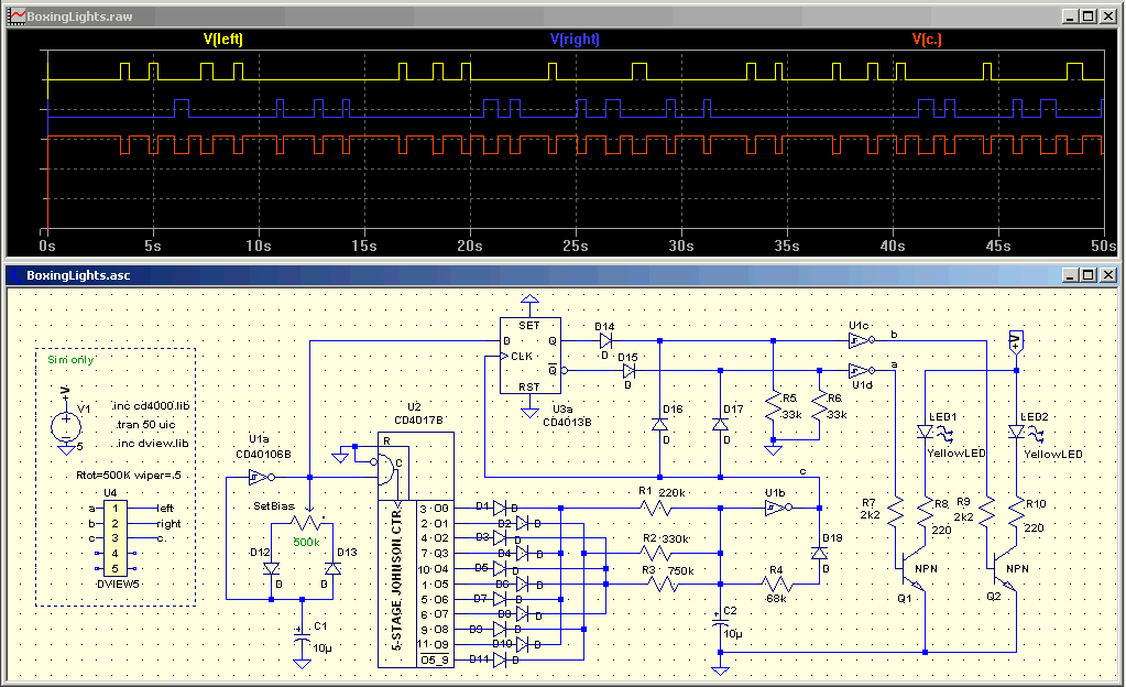

Something based on this perhaps (though it's a tad ambitious for an electronics beginner)?
U1a forms a first oscillator which clocks decade counter U2. The counter outputs switch resistors R1-R3 in a pseudo-random sequence. C2 charges via the switched resistor (not necessarily the same one throughout the charge period) and is discharged via D18/R4 under the control of U1b, thus providing a second oscillator. Since the U1a oscillator is anharmonic with respect to the U1b oscillator the pulses from U1b have a random period. R1-R3 and C2 are chosen such that this period is within the range ~ 1sec-3sec. The duration of each pulse is ~ 0.3-0.5 sec, determined by R4C2. Each pulse clocks U3a to latch the current state of U1a, hence providing a random left/right control output from the latch. This is combined with the U1b pulses in diode OR gates D14-D17, R5, R6 to switch on LED1 or LED2 for the pulse duration.
A potentiometer SetBias is included to adjust the mark/space ratio of the U1a oscillator so that the probability of left/right can be weighted in favour of one particular side. This allows a boxer to concentrate more on left or right punches as necessary.

In spite of the fact that you may as well have written that in Russian and I'd stand an equal chance of fully comprehending it, based on what little I know, that seems to be essentially bang on, with the positively brilliant addition of a bias pot to weight the blinking to left or right (a critical factor in fight training, since you may be fighting a southpaw)
I don't know how patents and intellectual property work in the electrical engineering game but if that does what I think it does, with the right 'external packaging', that could become standard kit in boxing/combat sports gyms.
You might want to patent that. You could probably get an existing sports gear manufacturer to tool up a production run, keep it equally cheap and simple, it would sell like a motherfucker and you'd get royalties.
If it does, please remember the poor moron on the internet who initiated the discussion and perhaps send him a free unit.
I do. Used to be my day job!
Now that I've published it I can't do that :). I offer it free to the world and his wife. The publication also means that no one else can patent it, so wouldn't be able to charge exorbitant prices in a monopoly market.
Sorry about the Russian, but the explanation of the circuit might be of some use to other forum members. Glad you like the bias bonus.
