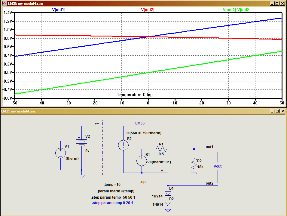

hi AL,
For reference, this image shows the effect upon the LM35 output when the two diodes are connected to the 0V pin of the LM35.
The 2mV/C change in forward voltage of each diode has to be catered for.
This also works on real devices on projects I have built, the LM35 outputs must be taken from the LM35 out pin and at the top of diodes, the 18K is also required.
Hi there Eric,
Yes, i am aware of the method used to get the LM35 to output voltages that indicate temperatures below zero as well as above zero by using two bias diodes AND an 18k resistor connected between the output and the minus supply. The thing is though, the circuit is not connected with an 18k resistor in this manner and i dont believe it is needed for his application either so i assumed the schematic was correct. If the original schematic is not correct then i guess that's another matter :)
Also what i thought was cool was the app note that mentioned turning the output into a current, which would allow a long run line between sensor and circuit without adding inaccuracies by the long wire length...Nice.

Hey Eric, did you by any chance take a look at why they use an 18k resistor in the first place?
Why that value? They seem to be assuming that the two diode drop together is only 0.9v instead
of the more likely 1.3 to 1.4v as two diodes like that normally drop. Any ideas there?

and its 1.4volt for both diodes...lol
