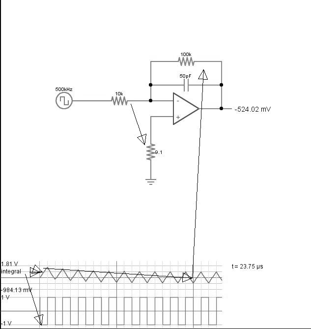

1/10K + 1/100k = 1/9.1k for matching input impedance to ensure zero Vio from Iin bias.

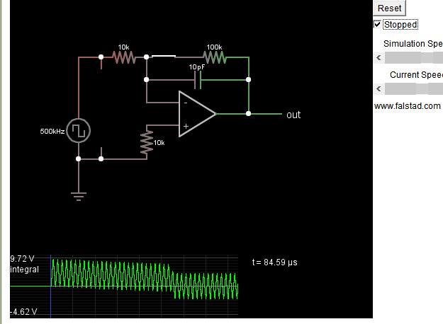

To test an Integrator , you sweep it from DC to 1MHz
At 500KHz when you start with a negative pulse, a "true Integrator has no Rf feedback resistor and positive voltage ramp begins that returns to zero and does not go negative. If you introduce a 3mV (5 max) input voltage offset due to mismatched source R on (+) it will integrate forever with a true integrator. In your case the gain is 10.
The overall gain , Av= --Zf/Zin = -(1/sC)//Rf) / Rin for feedback R =Rf
where as a true integrator is simply -1/sCRin as Rf=∞
Here I started the input 500KHz square with not shown with neg. polarity so ramp out is + then I closed switch which reduced DC gain from >1e+6 to 1e+1 or 10. so the output DC went to match the ref Voltage on (+) input, or gnd.
A true Integrator might use a dump switch when using low frequency signals since the RfC breakpoint defines the lower f limitation of the integrator.
