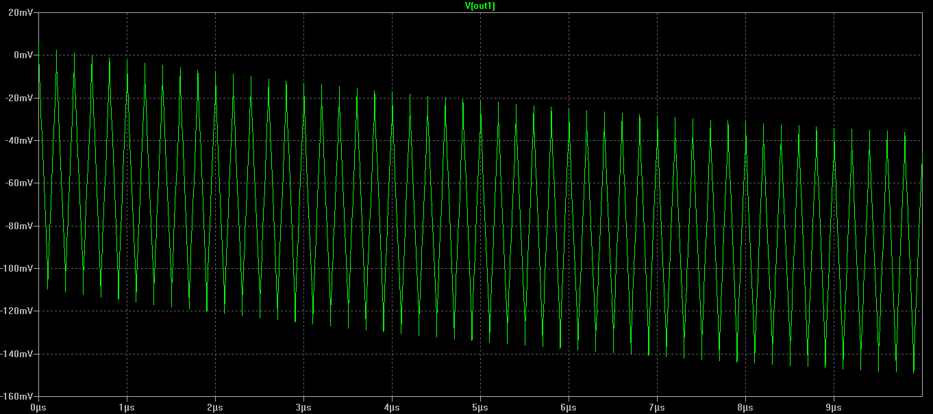

I was wondering why the transient output has no positive swing at all? Also why does it start at 0mV and drift to lower value as the time goes by? Also is the design of the integrator and opamp I have selected correct?

The drift is caused by the way Spice does a square-wave with finite rise and fall times. It subtracts from the low-time, making the square-wave slightly unsymmetrical. If you change the ON time to 99ns instead of 100ns, you will see less drift.
The integrator has a low output voltage for that input. Low output tends to increase the effects of any offsets in the circuit.

What you drew has a DC gain of 10. And a gain at 10mhz of about nothing. Is that what you wanted to do?
I think of an integrator as having very high gain at low frequencies.
That circuit does integrate the 10MHz square-wave to give a sawtooth output but the time-constant is such that the output voltage is low.
Adjusting the values of R1, R2 and C will indeed change the gain of the integrator.
A simple LPF will integrate the 10 MHz to a triangle wave. A true Integrator will ramp the output with DC input offset.

It settles down after the integration capacitor is charged to whatever DC offsets there are from the amplifier or differences in the ON/OFF period.

The time-constant of the settling time is determined by the component values and the real circuit response should be quite similar to simulation.
I realized my mistake. I did not put a resistor from non-inverting terminal to ground. This was causing offsets to DC offsets to appear at the output. But how can we make the integrator very precise?
