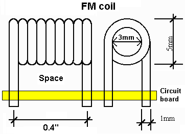

I didn't measure the inductance of my coils. I simply copied them from Rod Elliot's site. I used very thick (1mm) emamelled wire and wound them tightly on a drill bit. Then I spaced them away from the pcb and away from other parts.

Stray capacitance of the tuned circuit to other parts or to something near the pcb could change the RF frequency a lot.
You must use a plastic screwdriver to adjust the tuning trimmer capacitor.

Even simpler, those coils have always looked much more complicated than the bugs I made years ago.
I just used to strip the inner solid core out of TV coaxial cable, and wind something like 4 or 6 turns round a pencil, leaving a gap between each winding about the thickness of the wire.
Open and close the windings to adjust the frequency.

A suitably-sized snipping of sponge pushed into the inside the coil, and then a dripping of candle-wax after tuning, makes the coil very robust. A slight shift in frequency at first, but I think it's worth it.
My coils are made with 1mm wire.
They are so strong that they are not going away.
Yes, quite right 1 mm is already stiff enough, adding a 'hot-melt former' not neccesary.

looks like Audioguru was right... changing regulator almost everything went back to normal.. i got the same regulator as the one he used for his design only difference mine is the SMD version.
probably no need for ferrite beads...so i'll replace them with zero ohm resistors so i can confirm it.
but still i couldn't manage to bring it inside the 88-108MHz range.. i quited my idea of using axial inductors and i did the same coil as RFguru :D instructed but nothing.. so i went back to the axial inductors and i was keep replacing until i got an 180nH inductor and managed to bring the transmitter to the expected frequency range.
i need to understand which part of the circuit is responsible for that result...
i went into the conclussion that there is too little capacitance so that's why i needed higher value inductor, but why?? my trimmer capacitor has the right value...so maybe the capacitance of the LC is substracted because of the feedback capacitor?
My circuit might have much more stray capacitance as your circuit.
My oscillator transistor might have much more capacitance than your transistor.
I did not measure the inductance of my coil, I simply made it instead.
