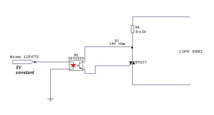

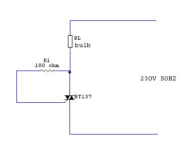

hello I'm making a remote dimmer and I'm having some trouble with the dimmer circuit. (opto isolator used is MOC3022 and triac used is BT137)
i use following circuit as the dimmer.but after supplying power bulb begins to flicker
but if i bypass opto-isolator triac turns on continuously
. can some one point me what is the error?
i have attached a video too

I deleated my response after viewing your movie. This doesn't look like a workable control circuit. The control has to be synchronized with the cycles of the mains in order for a triac to work. Otherwise, you can only control "on" and "off" I don't know why your light flickers as it does. I'm not familiar with your opto, but I suspect there are others on here who has knowledge of it.
but this is the circuit given in moc3020-3023 data sheet (only difference is in data sheet circuit has 240v 60hz)
edit: I just realise after I posted and deleted it. The MOC is a traic output.
Is U1 LED is connected wrong and leakage current is slightly turning it on?
output is connected correct way
Is the LED conencted right way round? ( I have to ask)
I can't see anything wrong with your 'trial' circuit, despite what others say about needing zero-crossing control.
If you're going dim though, maybe you do need some voltage detector circuit.
