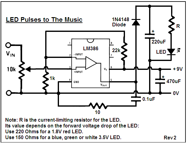

I'm making a circuit that takes in an audio signal, amplifies it, and outputs it to an LED which flashes in response to the audio signal. The current setup I have with the LM386 amp is working fine, but the problem is I plan to implement this into a pair of headphones, and the IC is getting power from a 9V battery which I would never be able to fit in the earphones. However, I do have a 3v 90mAh button battery which would work, but I can't figure out what the resistance should be between the IC and the battery. Currently with the 9V I have a 1K ohm resistor between the IC and the power.

I've tried removing the resistor, but what happens then is the LED is lit continuously, regardless of whether or not the amp is getting any input from the audio. A diode doesn't keep the LED off either.
Here's the simplest circuit on the datasheet.
You don't have to be a genius to spot the differences between it, and your circuit.
The DC output of the LM386 is half the supply voltage. So of course an LED at its output to ground will light.
You need to bias the input so that the output voltage is low without a signal and the signal will cause the output voltage to rise and light the LED.
The LED will look like a dim blur unless you add a peak detector diode and capacitor.
Do it like this:

Thanks, it came out to 150 ohms, which works perfectly. Problem solved.
Nice for minimum parts count, but you can improve energy efficiency;
Arrange the 1M resistor from Q1 base to gnd, keeping it just off. Replace Q2 with a PNP (obviously move the 47R resistor) so if Q1 turns on it turns Q2 on. Same parts count but ZERO power use unless sound input makes the LED light up.
