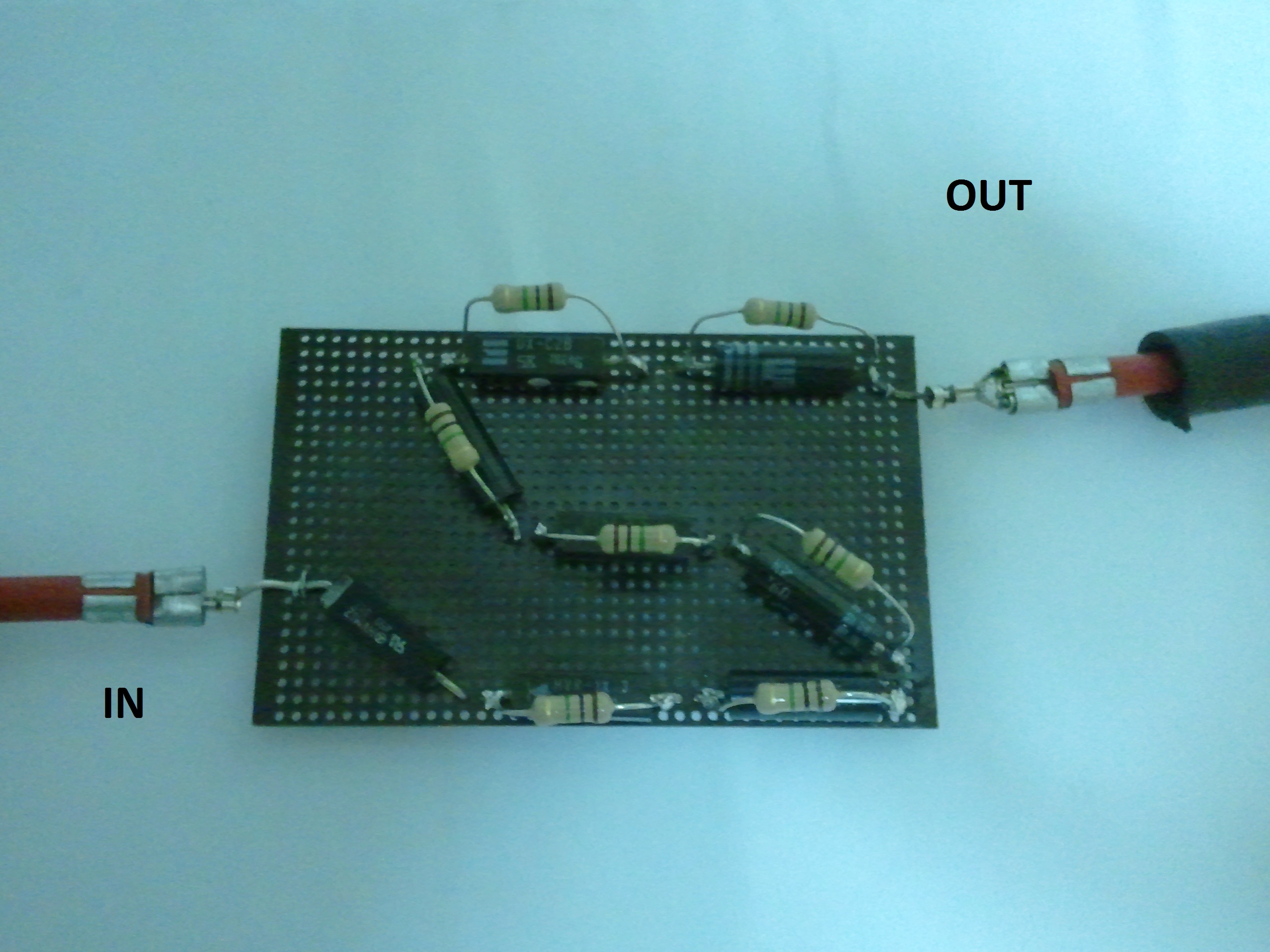

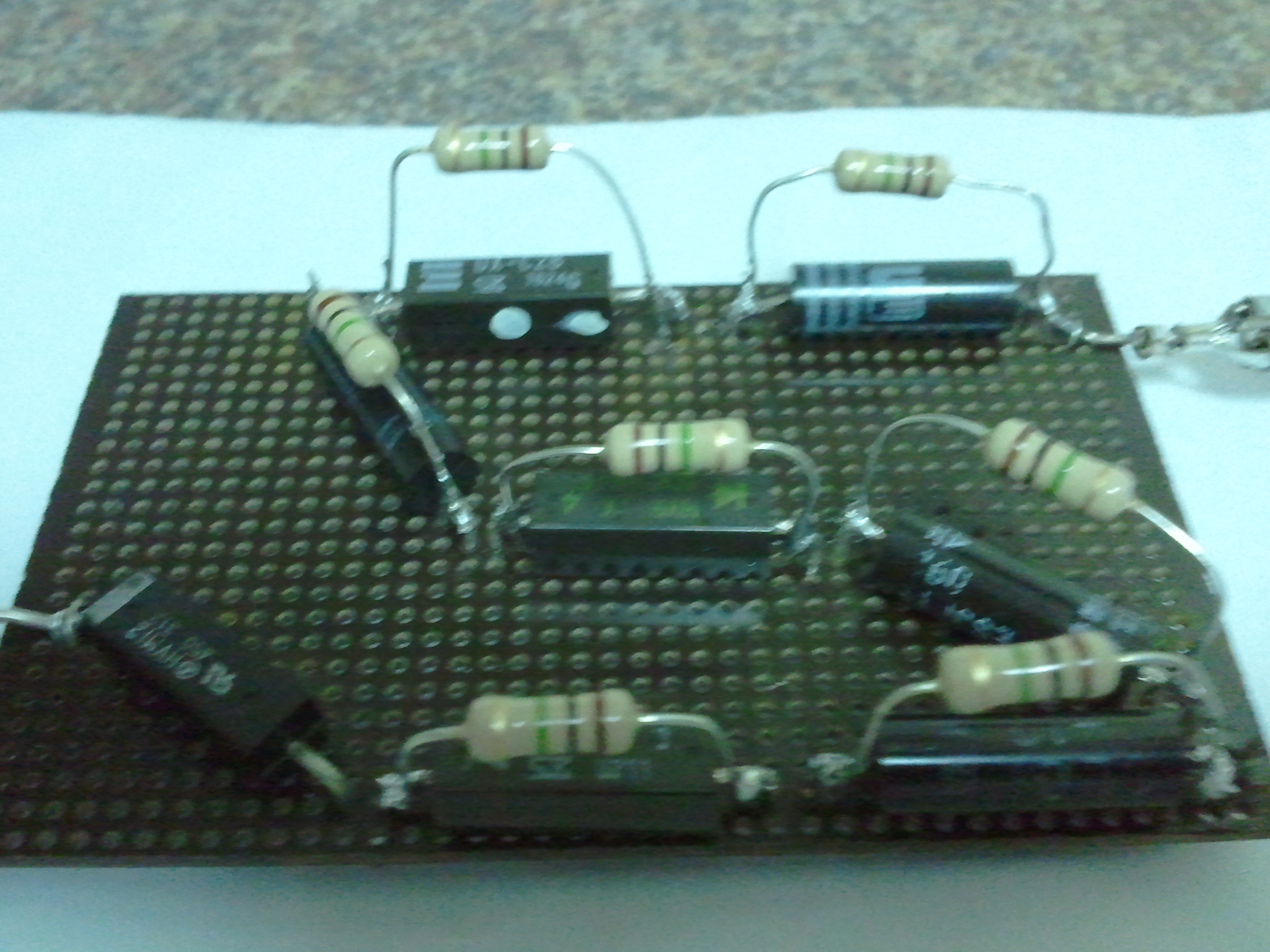

Some of those values are cutting it extremely close. 16,000 volts, for one thing, is probably far less than what your ignition coil is putting out. Also, the current rating is significantly less than what you really need. I wouldn't recommend using this type of diode.
Der Strom
just finished working on this need to know if its connected ok..
thanks
