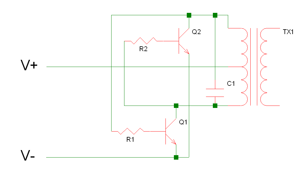

I know the HV winding and primary windings are good, I pulled the flyback from a Envision EN-980e Monitor that ran quite well, with no issues. It is one of the newer type, with all the windings and the HV diode cast in some sort of yellowish acrylic. I located the HV return, and using a simple 12vdc supply I have been able to produce arcs of only a couple millimeters.

Well after reading through the link to the project you are doing, I see it does not matter if the primary coil is good, you need to wind your own center tapped primary and feedback coils anyways, you only need the HV secondary winding to be good.

Wasn't really willing to spend $100 on this project, but anyways, how can I go about solving this issue with the low resistance? I doubt that the HV windings would have anything to do with it.

No the HV winding is not causing the low resistance reading across Vcc . I would double check your circuit again and the value and position of all the components. Just because you get a little sparking does not mean it's wired properly.
This is the same circuit I used and still often use for HV flyback type drivers.
The one I used in high school just used four turns of 14 gauge wire for each half of the primary coil and was wound on the core at the opposite end from the main HV end.
I used a pair of high gain Darlington transistors and a 12 volt battery as the power source. C1 is used to tune the resonance point of the coil.
Even with small computer monitor flyback coils this circuit when tuned right will still cover the outside of the HV coil assembly with a noticeable corona discharge and can shoot a corona discharge flame right off the HV wire end itself into thin air. I have made larger ones from old TV flybacks that could draw out an arc to around 3 inches and produce a corona discharge about a 1/2 inch thick off of the coil body itself. But large switching devices and a fair amount of power are needed at that point.
The more modern version uses a higher resistance for R1 and R2 and a set of IGBT's or Mosfets. A clamping zener across the gate to emitter or source is recommended though when using voltage controlled switching devices in order to keep from over voltaging the gate itself.

Thanks a lot for that, I will try that schematic tomorrow. What wattage do you recommend for the resistors?

The resistance and the wattage will depend on what type of switching device you are using. For transistors I tried to go for about 80% of maximum base current at a 2x input voltage.
The natural resonance of most fly back transformers is around 25 - 50 KHz so expect some fine tuning to be needed with C1. It can be left out but the circuit will drift its frequency far more as the input voltage and load changes.
