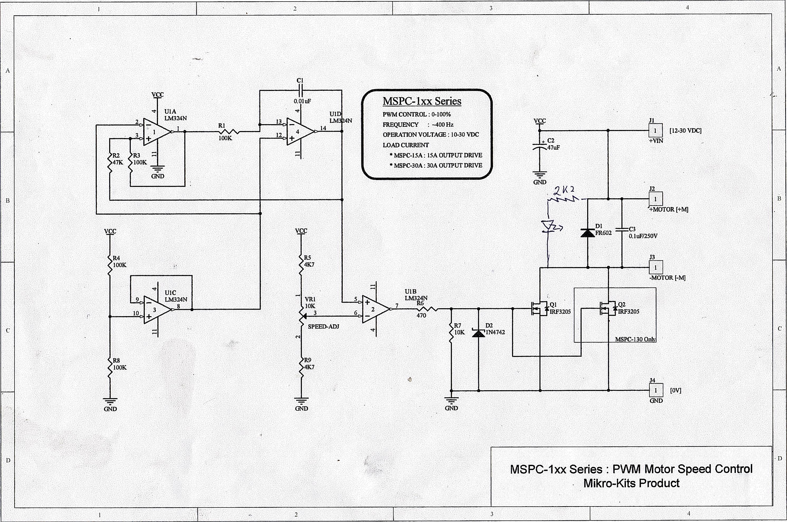

Motor speed controler
If you just want to control motor speed,you would be better off using a
Pulse width modulator (PWM).Use a LM324N Quad-op amp(8 pin IC)& a suitably rated Mosfet,the rest of the circuit only requires resistors & caps.and of course the usual diode.the circuit is controled by a potentiometer which adjusts the ampage via the gate of the fet & so to the drain.you will obviously need a heat sink for the Mosfet even if you are running at low amps.(I hope I've explained in the most un-technical terms that I can think of) good luck Terry
I agree with tblo163.
I designed a DC motor controller using a logic FET (N enhancement type) , PIC chip ( microcontroller), Schottky diode for connecting across motor.
Using very small amount of components (4 resistors, LED 5V reg and 2 caps)
you can get the circuit to dive motor at about 18-20Khz, have current limit detection, soft start e.c.t.
Only problem will be reversing. You could use a FET and a relay, or use 4 FETs (each has a diode in parallel to source and drain to snub back EMF) in a H bridge arrangement.
Shouldn't have a problem with reversing.The PWM's polarity MUST remain the same,but the motor's does not.bearing in mind that the negative to the motor is supplied by the DRAIN & not the source.Draw a diagram up,to see how this can work.
The PWM circuit is quite simple to build,on a piece of vero board,use a 14 pin IC Socket each side of the breaks in the rails.you can connect pins 2,12,9
&8 together,(they don't go anywhere else,the rest of the components are easily fitted,working you way to the Mosfets.You can use either 1 or 2 FETS,depending how much ampage you want to draw.I use two IRFZ48N,because I run at 30 amp continuous,you will also need a meaty heat sink and probably a fan.you can connect VR1 to opperate remotely if you wish.I've been running mine for allmost a year with no problems. I have a channel on Youtube,search for terryblount163 you will see why I need a 30amp, PWM.good luck Terry
  • LM324N.pdf
    LM324N.pdf

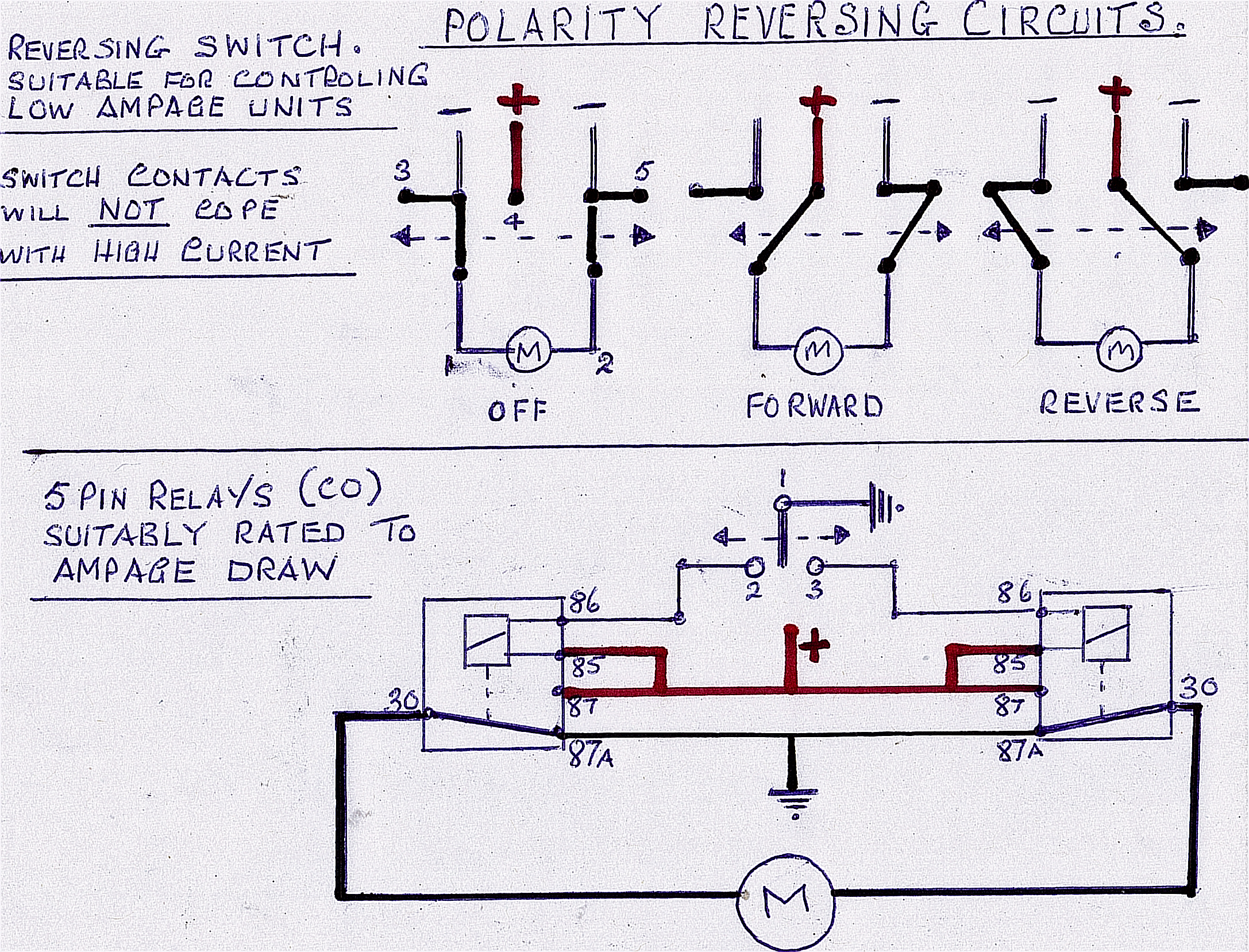

Hi ns5543,What exactly do you want to do with the motor? control speed,reverse it or both;Also what is the type of motor(some motors cannot be reversed)what is the voltage & current draw?Reverse polarity can be easily provided by two 5 pin relays(CO) & a reversing switch.An example of this to understand easily is a typical circuit for vehicle central locking.
Polarity reversing
Here's a couple of circuits to help you with your project.You will find this FORUM very usefull,just tell us what your problem is,and you will be surprised how many replies you get.We are happy to share our information with all who need it.By the way,what part of the world do you come from,I could possibly comunicate with you in your own language.good luck Terry
