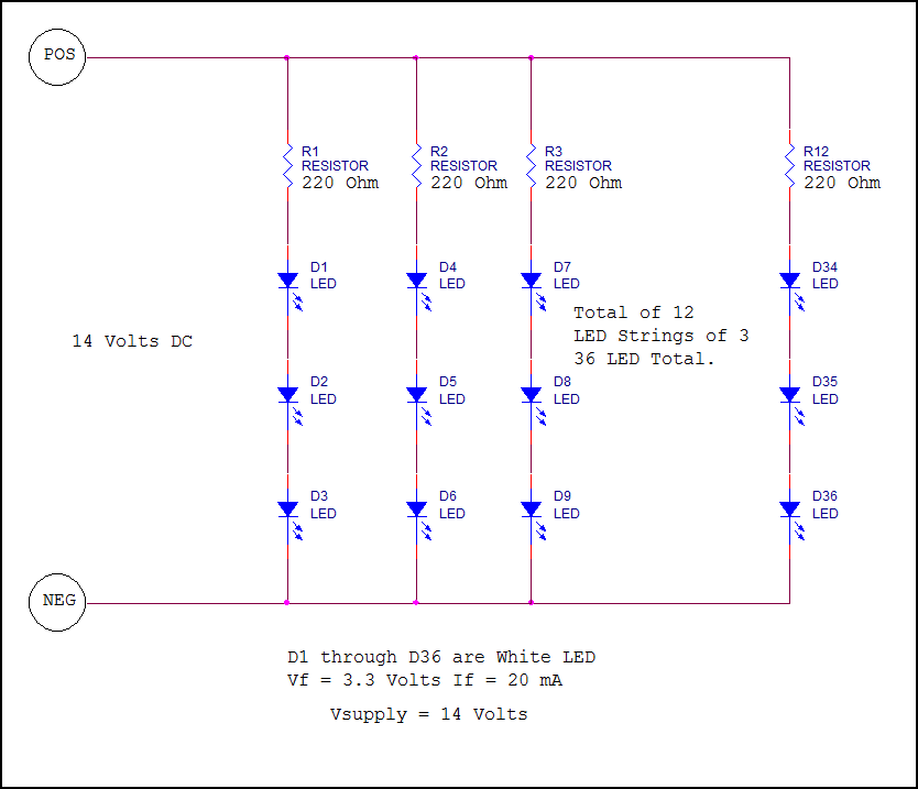

Hello I am hooking up 36 white led the power supply will be 14 volts dc what is the best way to hook them up and what Resistor or how many will i need
thanks
Do you have the specifications on the LEDs? Things like the forward voltage and current for the LEDs? White LED doesn't say much so there is nothing to work with.
Ron
One way to do it would be per the attached. Since you did not provide a forward current I winged it using 220 Ohm series resistors. That is based on Ifwd of 20 mA give or take which would be about 205 ohms. A common resistor is 220 Ohms. This is based on the 14 volts you mention. If this is an automotive application then all bets are off as the voltage will vary. Also if these are not 20 mA LEDs all bets are off also.

IT is 3.3 volts for the led the normal every day led .
A white LED with a "typical" forward voltage of 3.3V will be somewhere from 3.1V to 3.5V. You can use 3 in series and in series with a 180 ohm resistor. Then 3.1V LEDs will have a current of 26mA, 3.3V LEDs will have a current of 23mA and 3.5V LEDs will have a current of 19mA.
That is one string of LEDs. Make as many strings as you need.
If you are guessing that a car battery is always 14.0V then it isn't. When the battery drops to 12.6V then the LEDs will be dim.
Led
I don't have the package that the leds came with had them for a while. but i have a ac power supply that converts to 14 volts Dc. so its all the time 14 I hope :) But i a'm using it for a light at the house 36 leds in it so can i do a res and a string of 6 and keep going that way? all pos to pos and all neg to neg right ?
Nobody makes a 3.3V LED and you cannot order one. They have a range of voltages, from about 3.1V to about 3.5V for one that is "typically" 3.3V. I would use three in series with a 200 ohms resistor for one string and make many strings.
A normal 5mm LED works fine at 20mA to 25mA.
You can't do strings of 6. A string of 6 would be about (3.3 * 6 = 19.8 Volts/string). That is why I used strings of 3 with a 220 ohm current limiting resistor per string. Also, per AG, a 200 Ohm resistor would also work fine.
