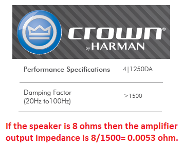

A modern amplifier has negative feedback so that its distortion and output impedance are very low. If you have an amplifier with an 8 ohm output impedance driving an 8 ohm speaker then you will hear boomy resonances and smeared sounds of the speaker. The negative feedback causes very good damping of the resonances and allows the amplifier to properly control movement of the speaker cone. A good amplifier has a "damping factor" of over 200 then for driving an 8 ohm speaker its output impedance is 8/200= 0.04 ohms.
Of course the amplifier must "be able" to drive the impedance of your speaker which is not its output impedance.
Here is the damping factor and output impedance of an excellent amplifier:
they must have a huge gain margin in their amps, but i must agree they are very nice amplifiers...
