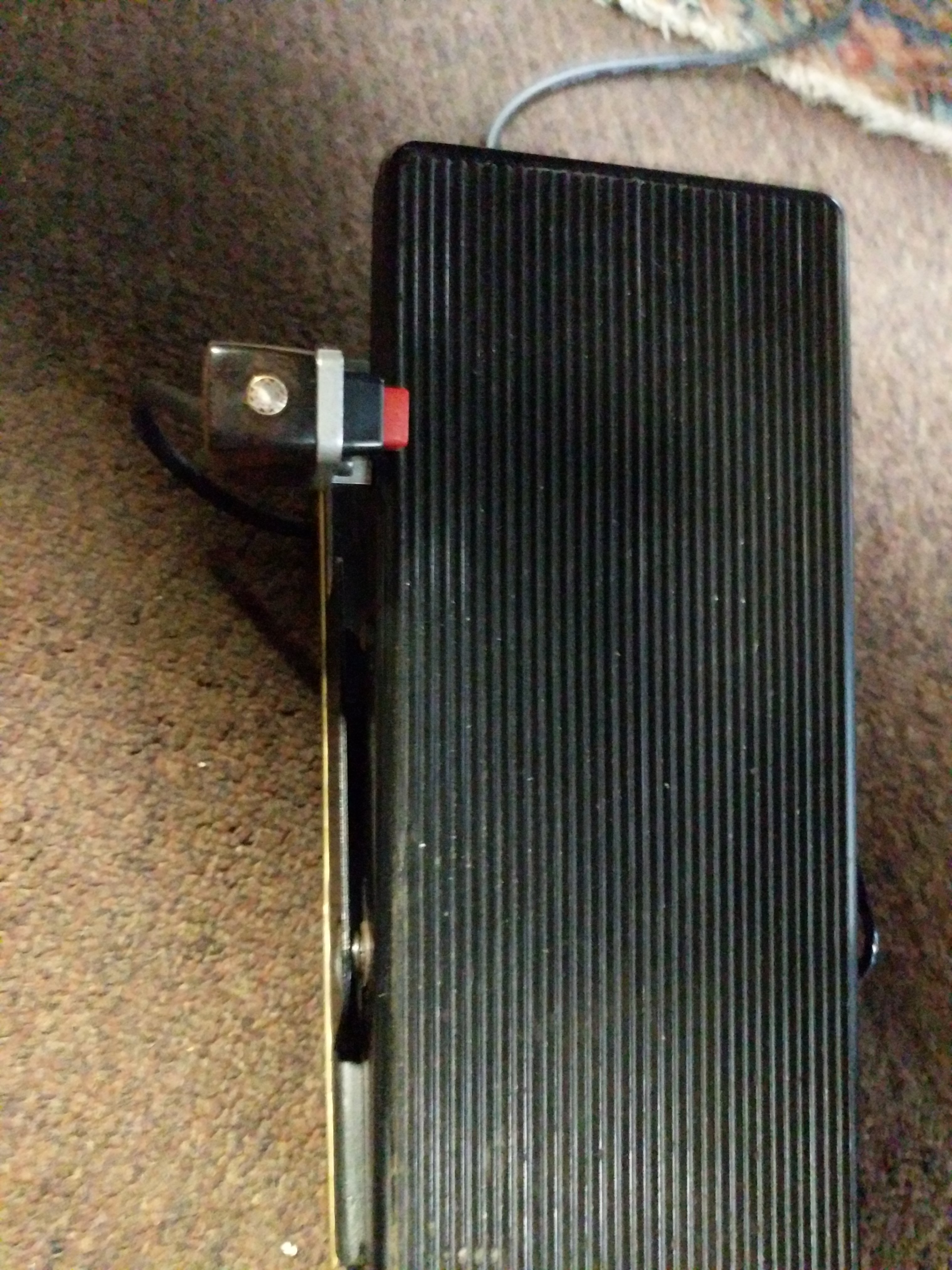

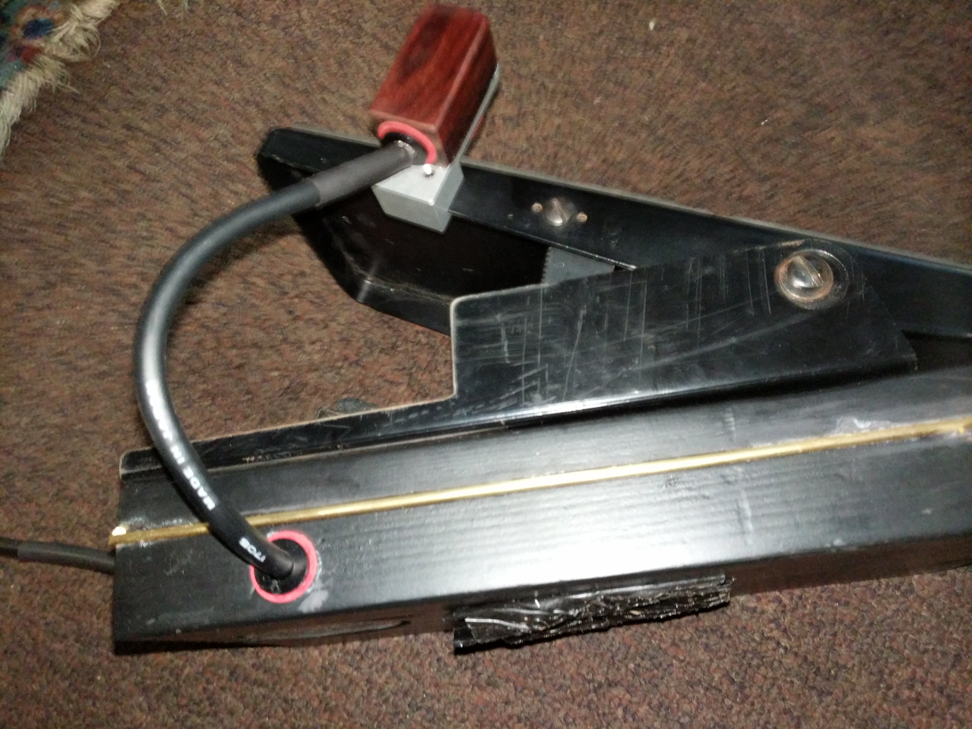

I was wondering if anyone could help me I work with a band as an organ tech we have a beast of a Hammond b-3 player and I've done a little work on his expression pedal by adding a remote switch for changing the speeds of our Leslie speaker system.
I would like to install some LEDs inside the pedal that would change color with changing the speed of the spinning Leslie which is accomplished by taking on the toe switch I have installed.
Line voltage 120 volts goes through this ittle switch I'd like to know how I can have LEDs glow red when the switch is off (with no voltage to this circuit inside the Leslie the slow speed motors are on and the Leslie is spinning slowly) and green when the switch is on (and the far speed motors are getting voltage and the Leslie speakers are spinning fast) inside the Leslie when the switch is off the speakers spin slowly and inside the Leslie when the switch is on the speaker spins fast.
. I am using LED strip lights around six inches long with the LED every inch or so powered either by a 9 volt battery or a phone charger for lighting 5 volts which I think is probably more suitable.
Here is a link to a YouTube video which tells you everything you need to know about a Leslie they're really cool.
. And here's a couple of pictures of another toe switch I installed on different expression pedal already.
.I know I can do this with a relay but I can't really find one small enough and electricly quiet enough. I was hoping there was a more elegant solid state solution that would be physically smaller and I'd be able to fit it in the space I have under the pedal.

Yes that is what I'd like to accomplish. Mount the two LED strips on the foot pedal and have the Red ligtup for slow rotation, and Green for fast rotation. The foot (actually a toe) switch is a simple spst soft touch latching push button. The LEDs strips are labeled 6v-12v 26LSM1 that's the red strip number I don't have the green with me. I am an electrician by trade and thought a relay would do it but as I said I know there is a way more compact and smarter more elegant solution here I really do not understand electronic circuits at all but I did recently buy a beginner Arduino kit and plan on getting started with that soon. This pedal project is on a fast track tho and so I appreciate any and all help you all can give me. Sorry for my lagging response it's been a exrra hectic week Thanks!

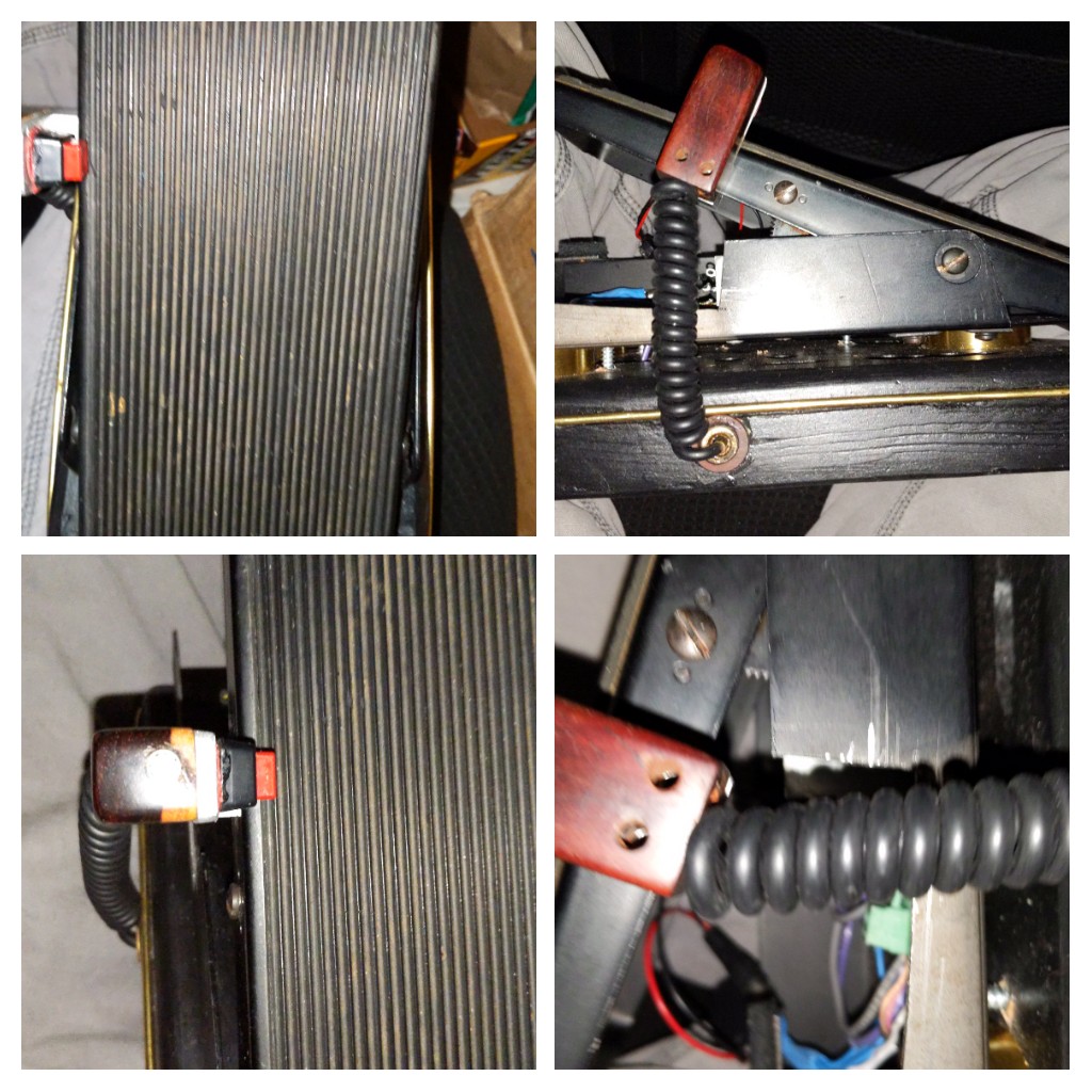

I can't replace the switch. I tracked it down and apparently it is an old radio shack"soft touch" sp latching push button. The soft touch is the important thing here as it is actuated by a subtle"push" with the players toe as he is moving the pedal up and down while playing, I've searched for another push button with the soft touch designation but couldn't find one suitable. Anyone know of something that fills the bill. Can I just wire a parallel set on contacts to create a dpdt switch. I can't think of a way to do that and keep the two sets of contacts isolated from each other. But yes certainly if u could somehow get another set of contacts or two even I could wire a simple circuit for each of the two colors. Yes a wall wart is called for here to power some LEDs that will glow BRIGHTLY it is going to look great but really the idea is for my organ player to be able to look down and know if the Leslie is spinning fast or slow before he pressed a key. Tonight I used the new pedal that I made for the first time and it worked fine I'll attach a picture. I want to put the LEDs under the metal that is mounted on top of the brass stantions. The led strip that I used was disappointing brightness wise but still looked cool. A red glow under the pedal is a subtle but fun look and when I get this figured out I think it will be helpful to my player and look great even if no one really knows it but the few people standing near it. I like my devices to look great as we'll as do there job. The little enclosure I made for the push button is cocobolo wood with s Mosaic metal pin embedded. See the close up of the switch. My soldering skills are sorely lacking. I need to invest in a quality iron for sure.

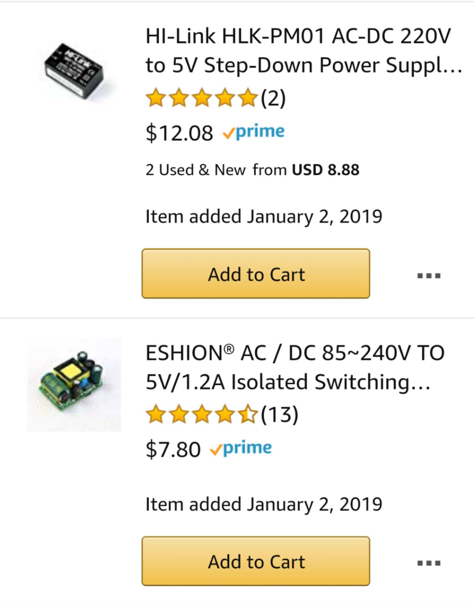

I think I came up with a way to accomplish what I've been trying to do. It would use one of these to (see attached photo) to step down the line voltage going through the switch to 5 volts using a 5volt to power relay. The relay would get 5 volts to the coil when the switch was active or closed and the normally open contact would close turning on the green lights when the Leslie was spinning fast then when the switch is opens the coil would not get the five volts and the normally closed contacts would close turning on the red LEDs lights . The leds will be powered separately and sized appropriately to the relay specs and LEDs I use. Any thoughts? Any suggestions on the relay? All of the 5 volt relays I see use some sort of trigger signal that causes the state change not just the powering or not of the coil. That is confusing to me. I look forward to your feedback and thank you very much. I also saw some ssr that may work the input being 120volts which then puts it 5 volts our 12 or whatever you choose to power the LEDs but I think I'm missing something there hmmm?Screenshot_20190108-134026.png
That image looks like a switching power supply. I'd be concerned with noise being induced into the audio.
You should use a small linear supply. Maybe a couple small 120VAC o 5/12VDC wall warts with just enough current to light each led strip. Also, if additional 120v wiring is routed in the pedal, it would need to be done safely.
