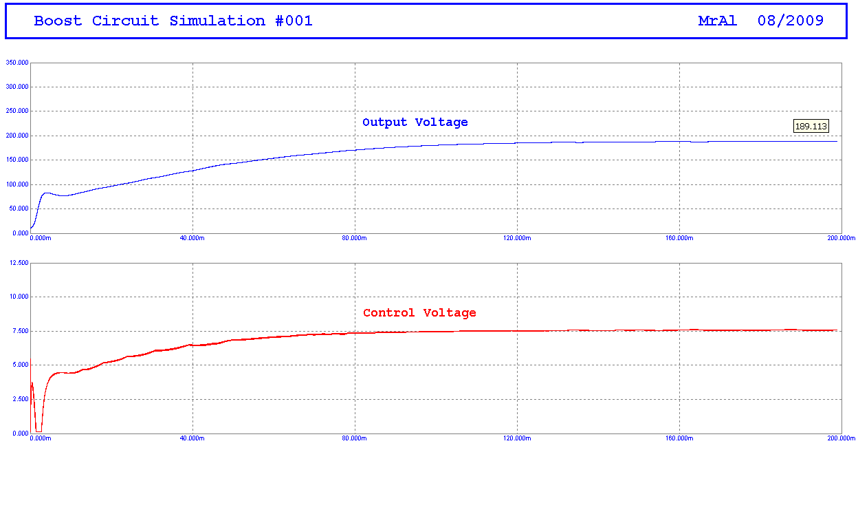

Here is a simulation of a boost converter output and control voltage
using the compensation networks i suggested previously and those
values as well. As you can see, it ramps up to 189v and then
stabilizes. I took all the values from your schematic this time.
This kind of simulation takes into account the inductor ESR, the
capacitor ESR, the switches ESR, and the *exact* control law as it
even simulates the control ramp and associated circuitry...no shortcuts.
What it does not simulate are the tiny little things, like MOSFET turn on
time, rise time, turn off time, fall time. The control ramp time is 19us
with 1us dead time (20us total). Load is 500 ohms (you do have a
small load dont you?).
If there is something unusual about that controller chip i will have to
look at that tomorrow.

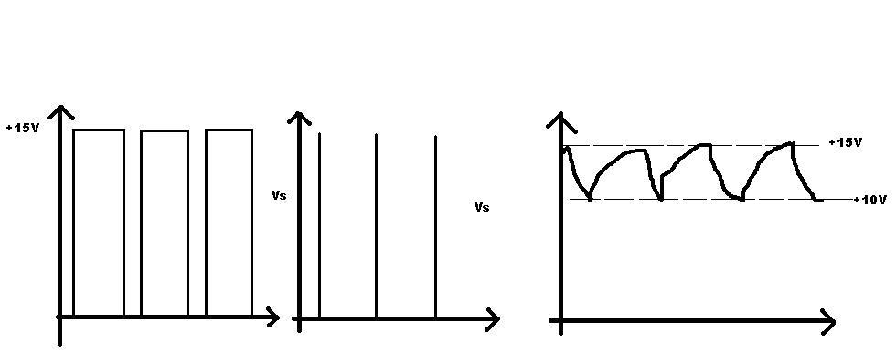

I eliminated the synchronous rectifier principle as some of you have suggested. I did this simply by eliminating the pulse to the sync rectifier. I also eliminated the NAND gate and the IR21844 gate driver (as recommended by Claude Abraham). Thus, I was firing only the main switch. The waveforms on the jpg attachment are schematics of the output signal of the UC3823n pwm controller. This signal is meant to fire the main switch through a 10 Ohm resistor. Now the first diagram is when the pwm controller is NOT connected. As expected the duty is max (About 85%). The second diagram is when I connected the controller to the mosfet. They controller is almost off and I have not even started supplying the boost with any voltage!! Thinking it was sourcing too much current, I replaced the 10 Ohm with a 110 Ohm and the waveform is like on the next image. I didn't even have the courage to start supplying the boost at 42V given these observations! I am using the IRFP360 mosfets.
I have also attached the datasheet of the UC3823n controller here. Please help me know if I have connected all the pins well for voltage mode control. Please, u can refer to an earlier post with my ISIS schematics (it's a pdf). For now, I am NOT implementing any current limiting. That's why I have grounded the Ilim pin. I just want to get something working first.
Edwin

the grounded Isns pin IS the big problem
Edwin
But with the Isns pin grounded, there is no servo control of the PWM. Once again, the pin on the UC3823 for current sensing is NOT MERELY a current LIMIT function. The regulation of the output voltage depends upon the sensed value of current. With Isns grounded, how can the PWM duty factor be controlled? How??
I can give you the name of a power electronics specialist company who can help you. If you have not "been there done that", too much time will pass until you learn how. With current mode control you MUST present a signal to the Isns pin. Even if you do not wish to limit current, the Isns pin cannot be defeated. Even if you wish to operate in straight voltage mode control, you cannot defeat the Isns pin.
Do not ground the Isns pin. If I may suggest something, maybe a voltage mode control IC would serve you better since current mode is unfamiliar to you. Is that something you would consider? As it stands right now, with Isns grounded, the Isns pin sees around 0 volts permanently. The error signal will always be greater than the Isns signal, so the PWM duty cycle will max out always. The dead time resistor determines the max duty factor. There is no regulation with the PWM constantly maxxed out. With a duty cycle limit of 85% max, a 42 V input results in a 280 V output!! At 90% duty factor, Vout is 420 V!
Tex Instr has a good app note on boost converters. SLVA57, 59, & 61 cover buck, boost, & buck-boost. It would help you. Also, I ran my spread sheet program I use for SMPS and found that sectioning the network using 6 parallel sections gives good results. I get an inductance of 23.5 uh per section, which is 5 4.7 uh parts in series. The "1.0 mh" on your schematic is what I assume as 1.0 millihenry, or 1000 uh. Is this correct? If so, that is way too large. At 80% duty factor, 50 kHz, the on time is 16 usec. The inductor ripple current is I = Vin*ton/L = (42V)*(16 usec)/(1.0 mh) = 0.672 A. This is way too small, and the inductor current is 110 A average. For a 1 section supply, the inductor ripple current should be 20 to 30% of the average current of 110 A. Hence the ripple should be 22 to 33 A. The optimum L value is around 22 to 33 uh. But the peak current is over 120 A! That is why I would use 6 parallel sections. I hope I've helped. BR.
Hi again,
Edwin:
Could you post a new schematic of your new connections? It's a little hard to
understand exactly what you have connected now, and a schematic is better
that trying to explain it in words. This will help a lot.
Also, could you take some scope shots of the ramp? I'd like to be able to discern
the polarity of the ramp and the associated circuitry so i can match my sim
model exactly. I need to see the ramp and the chip output pulse when it
is pulsing normally, however you want to get that to happen. This will help a lot too.

Instead of ramp pictures if they seem to be hard to obtain, a hand drawing
would be ok too, as long as they are from the oscilloscope and not a
theoretical drawing.
