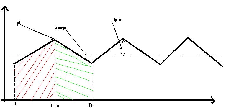

Have a look at the jpg.
Pk current = Iav + I ripple
If ripple is small (say less than 5%) then Pkcurrent =~ Iav = Iinductor.
The ramp is the current thru the inductor. The red-shaded area is the current thru the main switch. The green-shaded is the current thru the diode(sync rect). ALL have the same Peak current. What u calculated(22A) is the rms current through the load (i.e thru the diode (or sync rectifier)). If not convinced take a look at fundamentals of power electronics by RW Erickson.

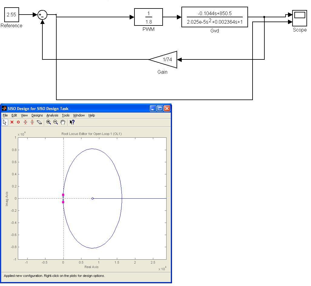

Hi MrAI,
Here is how I came up with the compensator.
1. I calculated the control-to-output transfer function for the ideal boost converter. Using section 8.2.2 of “Fund of Pwr Electronics” with the following parameters:
Vin = 42V; Vout = 189V; Power = 4170VA; L = 1mH; C = 1000uF.
I obtained Gvd (please see picture 1 – I do not know how to insert a photo directly in the text).
2. Obtained the transfer function of the duty cycler. Simply used 1/Vm where Vm is the valley-to-peak voltage of the ramp. The UC3823n has Vm = 1.8V.
3. Obtained the feedback gain H(s) as 1/74. Voltage divider circuit which should give 2.55V when output is 189V.
4. For now, I used no compensator i.e. Gc(s) = 1.
5. Plotted the root locus of the uncompensated system with these parameters (please see picture 2). As expected, there is a RHP zero at 1.3kHz and two complex LHP poles at 35Hz. The system is UNSTABLE (because there are loci in the RHP).
6. I set the design objectives as: Settling time < 0.05s; overshoot < 5%.

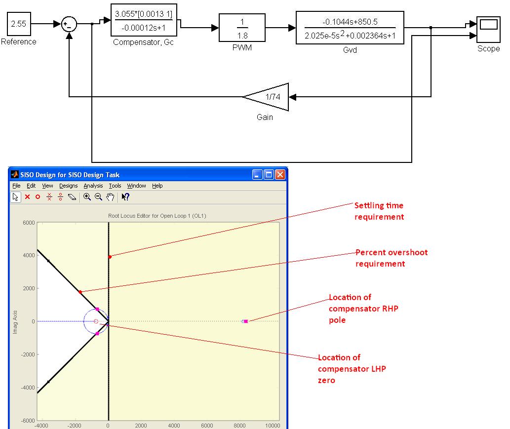

7. Compensator design starts:
a. Inserted a pole very near the RHP zero. This has the effect of cancelling the loci in the RHP. I chose a RHP pole at 1.326 kHz.
b. Inserted a zero in the LHP. This has the effect of “pulling” the root locus towards the left. I chose a LHP zero at 122 Hz.
c. As of now both these actions result in a compensator with a unity gain.
d. Noticing that the closed-loop poles were not really satisfying the design objectives (settling time and overshoot), I moved them till they satisfied these objectives. This gave a gain of 3.055 (i.e. 9.7dB).
e. Please see picture 3 for the overall compensated system showing the design objectives.

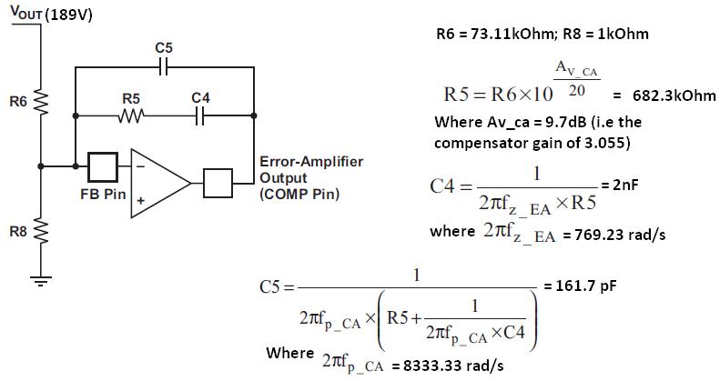

8. Using a note from Texas Instruments (I posted it earlier in this thread. It is called “Topic 3”), I designed the compensator components as shown in picture 4.
I wish to add that unlike what RCinFLA thinks, I am not testing at 4kW yet. I am using a much reduced model. In fact during testing, the ONLY load was the voltage divider at the output. I was thinking that if the control system works for a little model, it should perform as well for a larger model (if working with the same circuit params). I also want to master the design of such control systems so as to modify circuit parameters and still obtain desired results.
Please point out all errors I made (this is certain because the control system did not work) and suggest a methodology. Thanks for your useful suggestions and remarks.

Hi RCinFLA,
Thanks for the suggestions and the link. Concerning the link, I examined the diagram. In effect, the boost part is a push pull configuration at about 25kHz (Rt,Ct combination yields this frequency).
Tried reverse-working the compensator frequencies from the values of the feedback compensator elements. Seems that the compensator pole frequency f_p is at 0 while the zero frequency f_z frequency (fz) is 1.592kHz with a gain of -32.869dB (corresponds to 0.023). Seems "my" gain is far above this. How did they obtain this value?
Is push-pull absolutely necessary for this project? I ask because my pwm controller UC3823n is not push pull. And too, I want to avoid a transformer if possible. I am not working at 4kW yet... I am still almost off-load with a reduced model.
Thx. Edwin
As I previously noted, your duty cycler gain is much too low. You did not include the gain from the duty cycler output to the switch output. 0 to 100% duty-cycle gives 0 to 250V output. Thus the gain from the duty cycler input to the switch output is 250/1.8 not 1/1.8. The high gain factor of 250 times what you used likely will cause instability if not accounted for in your compensation network.
For the ideal boost, 100% duty should give an infinite output voltage. For the real boost, 100% duty should give 0V. The relationship b/w input & output is non-linear (vout = vin/(1-D)).

Hi again,
Well, i asked to see your plant because i have no trouble compensating a
normal buck output circuit but you seem to be having a problem here, so
i thought maybe there was something wrong with the equation for the plant.
If you show me that i might be able to help more, but without that i can
only take a guess (see below).
I ask about this because there are a couple of problems, as i said:
1. Your compensation equation only shows one power of s, yet the scheme has
two capacitors. Are you considering one to be insignificant?
2. Your compensator equation part looks like this:
3.055*[0.0013 1]
and there is a space between the '13' and the last '1', what does that mean?
That space makes no sense so you should explain that.
In the mean time here is a guess on what to try:
C1=10uf (with + terminal toward op amp input)
C2=100pf
R3=1k
Across R1 a forward network:
1k in series with 0.15uf cap
Across R2:
4.7v zener, anode to ground.
Try these and report back.

Hello again,
With this changes:
C2=100pf
R3=1k
Across R2:

Keeping that in mind, the above changes produce a fairly quick response
that exceeds his requirements.

Hi MrAI,
Thanks for your suggestions.
I appologise for my assumptions. Actually, in MATLAB [a b] for a transfer function means aS + b. Similarly, [a b c] would mean aS^2 + bS + c... and so on. MATLAB represents transfer functions as row matrices.
I am grateful for your suggestions on compensator values. Immediately I get to the lab, I'll try them and give feedback as you said. Then (when it works) you owe me a COMPREHENSIVE course on compensation.:)
I will post my boost design if that is necessary (didnt think so given that it is a classical boost structure but with a sync rectifier - and which worked when I used a function generator instead of the pwm controller). Right now I am on the move, in about 4 hours time, i'll post the design.
